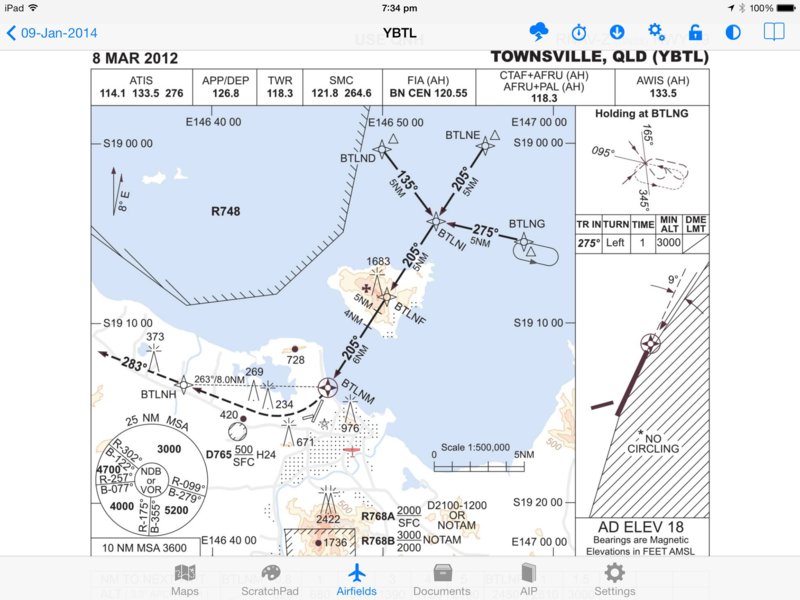

frank marriott Posted February 3, 2014 Posted February 3, 2014 Ben This is the RNAV approach for RW 19 at townsville. The little red aircraft shows your geo position on the approach. As you would be aware and stated in previous posts it is not TSOed but for practise in VMC it is great. You can't log it for currency but you can certainly fly it for practise on a visual approach. The Geo position of the red aircraft is my home address and if I wanted to fly the RNAV approach from that position - all too easy. The minima is displayed on the bottom of the same page not in the photo. I am not aware of portable TSOed units (not saying that there isn't any) but for practise in VMC I think it is great. You obviously need a DME of some sort - I have a Garmin 296 dash mounted (also not TSOed) so only ok for practise in VMC but it gives you all the info required to fly the approach.
