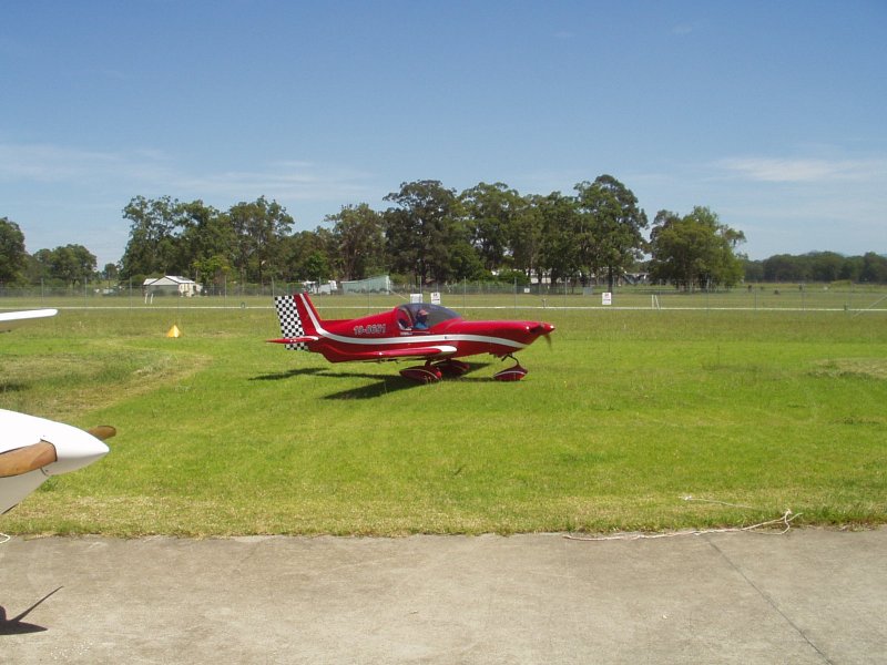

1148851461_IMG_0700(2).JPG.c083d5b5eb64dd095f727741d498fb39.JPG Hi Guy's
19 5234 is now complete at least I think so will get the W&B and condition report done in the next week or so then will be waiting on RAA and their needs.
A couple of You Tube clips you might be interested in showing her complete and running for the first time in a while about 2 years I think.
Cheers
David
