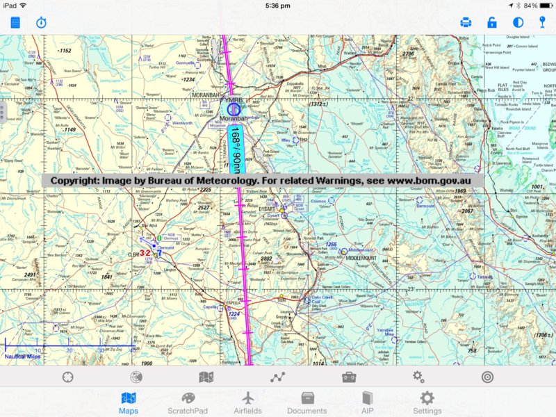

Guest Maj Millard Posted February 20, 2014 Posted February 20, 2014 Have you all seen this....it is brilliant ! Wx presented on map, and in relation to our planned route line, real time....Yeehaaa......thank you Bazza and the boys at Ozrunways !!.....the best just keeps getting better..............Maj....

Russ Posted February 21, 2014 Posted February 21, 2014 Query.....how much does this radar/weather chew into my data plan. Hate to get a mind blowing charge from Telstra.??
Hongie Posted February 21, 2014 Posted February 21, 2014 It will use data russ, but I can't imagine it being more then a few hundred Kb per cycle. 1
Russ Posted February 21, 2014 Posted February 21, 2014 Thanks Hong, example, several days back I was way south heading north (home) Approx 3 hrs weaving me way through rain cells etc , couple of times I had to backtrack to find a clearer passage elsewhere, to cut a long story short, we made it. So......running this radar overlay for hrs at a time, would chew how much data plan?? Russ
Hongie Posted February 21, 2014 Posted February 21, 2014 again, not much i dont think mate, as it only refreshes every half an hour or so i think. Bas may be able to provide some more input here. Just be aware, that this weather is not strictly real time. I would not rely on it to avoid weather. There will be a delay, I'm not sure how long. Even the ADS-B weather that they get in the US is delayed by up to 10 mins I've read.

Guest Maj Millard Posted February 21, 2014 Posted February 21, 2014 Thanks Hong, example, several days back I was way south heading north (home)Approx 3 hrs weaving me way through rain cells etc , couple of times I had to backtrack to find a clearer passage elsewhere, to cut a long story short, we made it. So......running this radar overlay for hrs at a time, would chew how much data plan?? Russ Russ, You have the option of quickly and easly switching it on and off, obviously if there is a lot happening you'll probabily want to leave it on, however the option is there to just use it as a check on WX every now and then as you may be presented with it out the front window.............Maj.....
Guest Maj Millard Posted February 21, 2014 Posted February 21, 2014 o again, not much i dont think mate, as it only refreshes every half an hour or so i think. Bas may be able to provide some more input here.Just be aware, that this weather is not strictly real time. I would not rely on it to avoid weather. There will be a delay, I'm not sure how long. Even the ADS-B weather that they get in the US is delayed by up to 10 mins I've read. hongs, I looked at the multi colored WX forcast overlay but found it nex to useless. As it is a forecast, what is the delay in what you see displayed, to when you actually get that WX ??.............Maj.....

Hongie Posted February 21, 2014 Posted February 21, 2014 I've not looked at the forecasts on there, just the radar. Not sure what the actual delay is, just i'm aware that there is one, and also the fact that the BOM only displays 10min intervals

Kyle Communications Posted February 21, 2014 Posted February 21, 2014 do you have to be actually flying to get the overlay radar on the screen…mine just comes up in a window
frank marriott Posted February 21, 2014 Posted February 21, 2014 I've not looked at the forecasts on there, just the radar. Not sure what the actual delay is, just i'm aware that there is one, and also the fact that the BOM only displays 10min intervals Hongie It IS the BOM radar overlaid on Ozrunways charts - so you are correct in saying not actual time, 10mins and sometimes more between updates. Displays on whichever chart you select.
Guest Maj Millard Posted February 21, 2014 Posted February 21, 2014 do you have to be actually flying to get the overlay radar on the screen…mine just comes up in a window No Mark, It'll come up anytime....you may need to have a route selected.....used to come up in a box, which is still available with the normal wx button....

Kyle Communications Posted February 25, 2014 Posted February 25, 2014 sorted the weather display it helps where to know how to turn it on On another matter the TV dongles finally arrived today so hooked it all up connected to just a vhf antenna system here. I had the wifi working fine but just needed the specific version of the dongle….wow does the adsb display work well….just fantastic got my own personal flight radar 24 screen..it shows aircraft call sign and height…I would summize height they transmit maybe not from my height
Kyle Communications Posted February 25, 2014 Posted February 25, 2014 for anyone else who doesn't know you turn the wx radar on in the settings that has the suitcase port

Guest Andys@coffs Posted February 25, 2014 Posted February 25, 2014 Hey guys, lets have a quick refresh of how radar works so we don't get into the terrible predicament of believing as gospel all we see on DaScreen....... Radar is line of sight and at the frequencies used by the BOM doesn't bend at all.....the earth surface is round and as such the further you are away from the BOM radar sight the less the ability for it to display what is happening at the altitude you fly at.....go too far from a radar site and if it displays anything at all it wont relate to what you are seeing at our relatively low flying altitudes. Further, and obviously, it cant show what it cant see. BOM doesn't have sufficient radars to offer continuous coverage at our altitudes on the east coast let alone the rest of Australia, so no Ozrunway displayed weather don't mean no weather...... Andy
