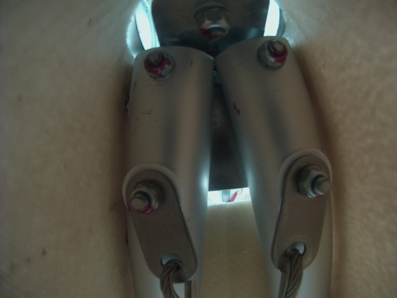

cscotthendry Posted February 22, 2014 Posted February 22, 2014 G'Day. While doing the annual service on my Nynja, I came up with a new use for my GoPro. I attached it to a monopod and shoved it into the inaccesible areas of my wings and the tail. I got some great pics of the frame, fasteners and bracing cables. The GoPro has a wide angle lens so pointing the camera is not particularly critical. Also since version 3 of the GoPros, they have wifi and can be controlled remotely with an iPad or iPhone. You can also get a preview which helps positioning the camera for the best shot. I'm sure that other sports cameras would be equally useful in this regard. Finally, the pics will be a good comparative reference for the next service. 1 2
Ultralights Posted February 22, 2014 Posted February 22, 2014 great idea,, currently rebuilding the carbys, and using the gopro to document every step. didnt think of using them for internal inspections,
Jabiru7252 Posted February 23, 2014 Posted February 23, 2014 As long as it doesn't fall off and into some inaccessible area!!!
