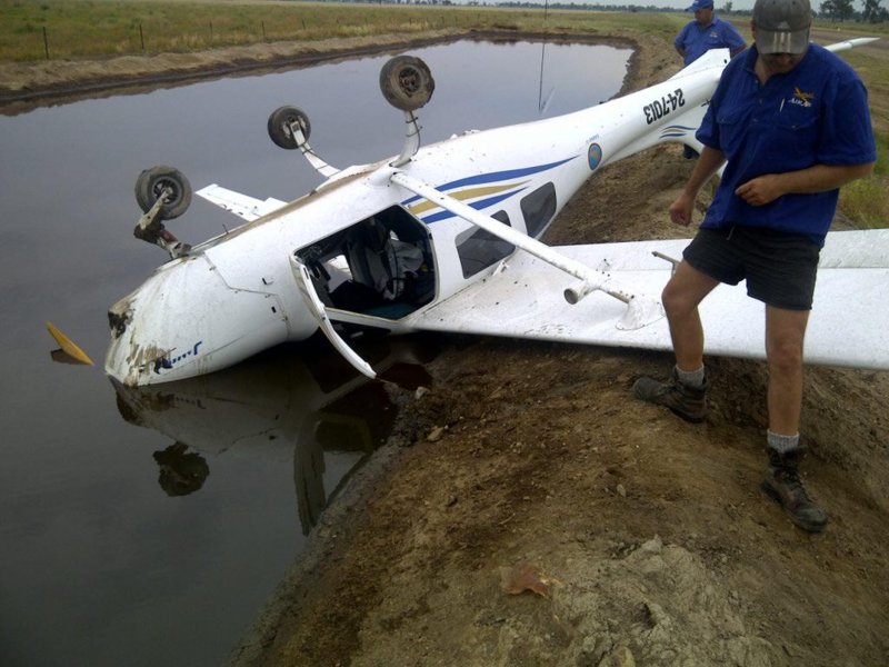

Oscar Posted February 24, 2014 Posted February 24, 2014 Oscar I will see if I can dig the pics up from the original accident. Not that much can be seen, but i cant recall if the rear spar connection failed or not. I dont think it did. Merv, from the description, I doubt it did; to tear along the spar you'd have to have a major shear load in the wing skin as you said, so if the rear attachment had failed then that would release the shear load. Once the shear strength has gone, then the load on the rear attachment reduces dramatically, so it's one or the other goes first... Your surmise that the tear started from a high stress point introduced by an interruption to the skin sounds entirely likely, though obviously the skin/mainspar attachment produces a line of high stress that could act a bit like the fold in an envelope.. The solid wings are as tough as hell, basically; they'll withstand a crash that cuts them open from the l/e back to the spar ( e.g. hitting a fence post or the like) and be entirely repairable. They're only a write-off if the spar is damaged. I don't know much at all about the later wings so can't comment, but I guess it's the old story: more technology, less forgiveness. There just is no free lunch; the reason a J120 can be put out Jab's door for such a low cost for what you get is a factor of the cost of production: those solid wings are cheap to make (and repair) but you trade that off for losing the room behind the seats to a fuel tank and a lower useful load. It all comes back to the rather complicated equation of 'what do you want from your aircraft'? If I were flying mostly one-up and wanted a minimum-maintenance, reasonably-performing, safe if it all goes pear-shaped device (which I do!) that I can head out to most anywhere in this country, a J120 with a full CAMit-modified engine would be damn hard to beat for the money - possibly impossible to beat. Pack 200 mls of LC3600 and a sandwich-bag full of appropriate 'glass and you can repair it pretty much anywhere en-route that you have a mid-level oopsy, if you have the basic knowledge of 'glass repair techniques... and your chances of being in a physical condition to DO a repair is pretty damn good. 1

motzartmerv Posted February 24, 2014 Posted February 24, 2014 Thats the one Oscar. Im 90% sure it was the right wing that subsequently failed during the forced landing. The left wing broke both front and rear spa connections. I think. It was a few years ago and i never saw the wreck. So dont quote me.

kaz3g Posted February 24, 2014 Posted February 24, 2014 ..The right wing snapped right down the middle. It seemed (from what I was told, I never saw it) that the crack propagated out from the fuel tank hole and cracked off beautifully in an apparent shearing load. It was assumed that the impact of the forced landing was not enough to cause the snapping of the wing, so therefor must have been an undetected issue from the previous accident. Im sure Jab would have some records on this incident if you want to check out what became of it. Im not sure myself as the satellite school have now gone on their own way.. Cheers No doubt such things will show up more frequently when CASA introduces SIDS for everything that flies. Kaz

Oscar Posted February 24, 2014 Posted February 24, 2014 Merv - that's really, really bizarre - wish we could see the view from the other side. I don't mean to be combative here - but the 'break' line on the port wing is so extremely clean, and noticeably at the level of the water surface - and that water is very, very opaque. The glass used (certainly in the solid wings) is a biaxial 90-90 glass laminate laid at 45 degrees to the spar, so a spanwise tear would be jagged. Did you have a report that the wing had torn spanwise? - (that appears to be well behind the spar line). The starboard wing appears to be fairly normal in that piccy; the later failure MAY not have been a result of the earlier one - though any wing that is repaired is suspect unless you have explicit details of the damage and the repair scheme. That said - repair of a 'glass laminate is documented to be 100% 'as good as new' - PROVIDED that the proper techniques are used. Same goes for any material, really, it's just a case of how much 'repair' is needed. 1

motzartmerv Posted February 24, 2014 Posted February 24, 2014 No sorry oscar, I didn't have anything on it. It wasnt with my school when either of these prangs occurred so im only going on hearsay. But donnie (the CFI) said jab found it a very odd failure as wel and they replaced the wing as part of the repairs. The insurance company gave them stick over it, but I think it was eventually sorted. The pic was taken after it had been skull dragged up the bank.
