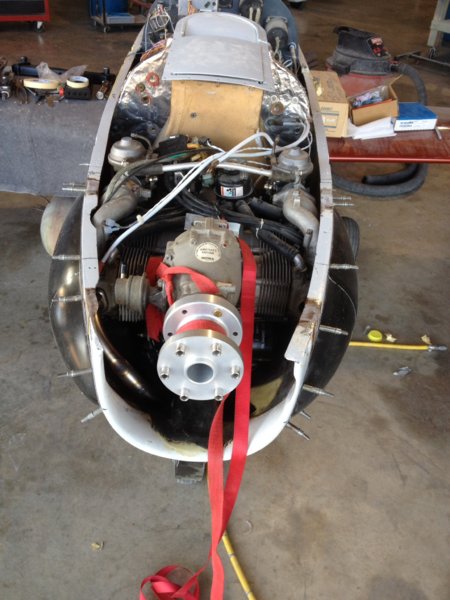

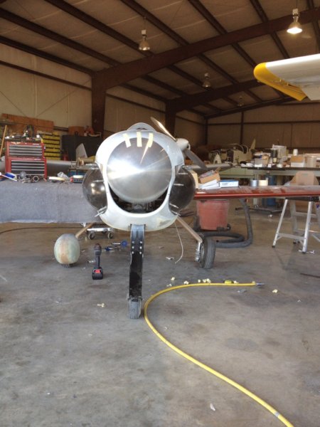

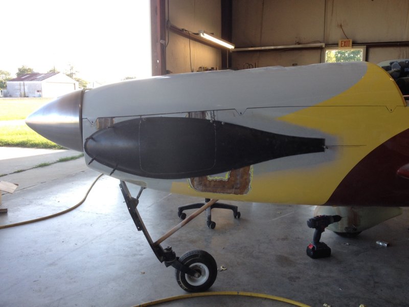

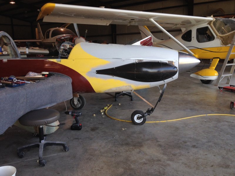

The new cowl cheeks have been fabricated from carbon. They have been clecoed in place on the cowling and doors have been cut into them to facilitate working on and removal of the engine.
Here are some pics.
Due to the slightly higher positioning of the prop shaft with the Rotax installation combined with the new spinner that we have to suit the installation, we shall need to build up the upper surface of the cowling where it meets the spinner to fair it all in nicely. This is only a minor job so won't take long.

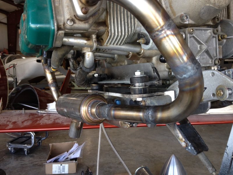

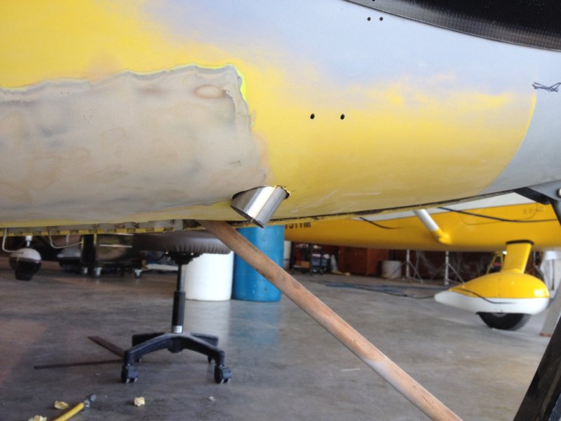

The custom exhaust system has been squeezed in and is now fully welded up. Lanny has done a really good job to fit it all in.

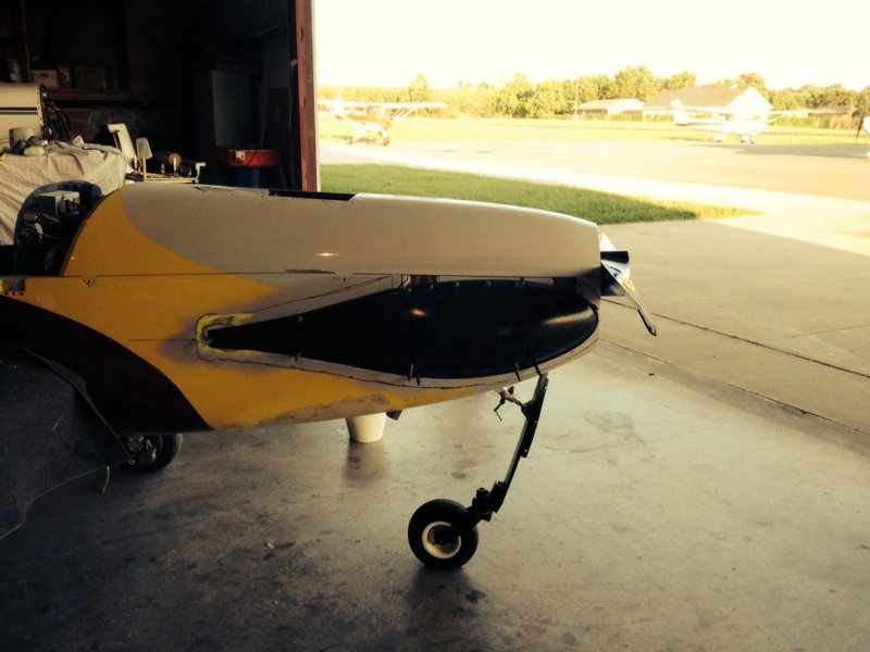

Lanny has now removed the engine to do a final check of things before the engine goes back in for good (hopefully!). He has hooked up a number of the systems, i.e. The nosegear retract system, exhaust etc..
The nosegear retracts and extends as it should.
And the exhaust has been squeezed in nicely.

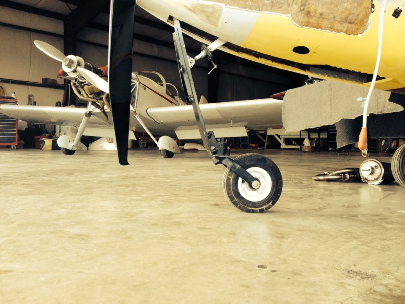

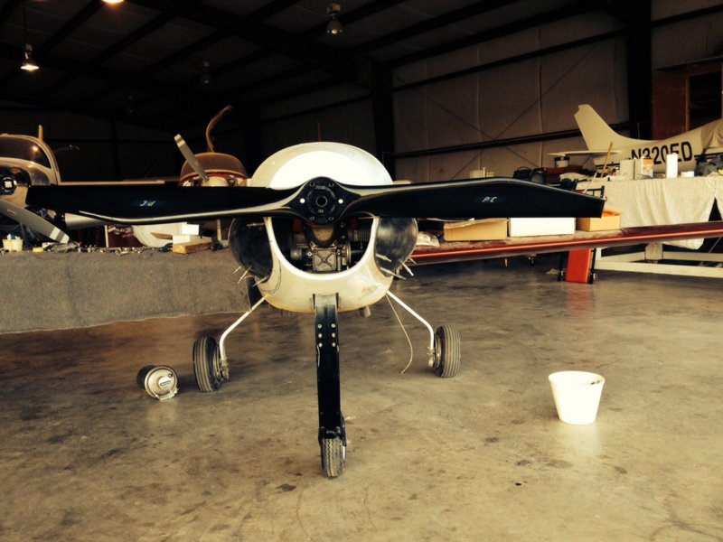

The new custom prop has been trial fitted. We have increased the prop diameter from the original 54" diameter to 62" on the new prop. We have also increased the pitch from 88" to 93". I can hear your gasps already! However, we will need 93" pitch to get 200 knots with the Rotax engine (yeah, we're probably dreaming!). 93" pitch will have a pretty well stalled prop in the static situation. Static thrust is anticipated to only be in the vicinity of 100lbs and up to around 200lbs at 50 knots. It then improves as the aircraft speeds up. It is estimated by the prop manufacturer that best climb speed will be around 120kias. Prop clearance is only 6.25" but Lanny moved the nosegear strut attach point to a lower position and this has stiffened up the nosegear spring appreciably. Lanny has bounced all his weight on the nosegear and it gives around 2" so hopefully we have adequate ground clearance with the prop. If I post photos of a broken prop after the first test flight, we will know that we were wrong :-(

I woke up this morning to find the photos of your weekend work from Lanny. Great progress! You've done an outstanding job on the cowl cheeks and gear fairings. That Bug looks so good!
