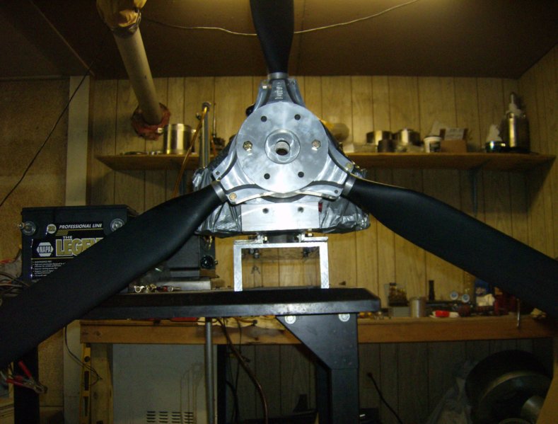

flyvulcan Posted June 28, 2015 Author Posted June 28, 2015 A J-57 by chance? BTW, are you cornering the market on the Bug scene? I am curious; how many are there in the worldwide fleet? I am trying to corner the market! There are only 2 others that I am aware of in existence that I or Lanny don't own. They are N63974 and C-GANT. I've been trying to buy N63974 for the last 5 years but can't get the owner to sell. It's sitting forlorn in a hangar and probably won't fly while the current owner has it. C-GANT was too expensive for me... Lanny has Nick Jones original prototype #3, N200NJ and its restoration will start soon. We also have a few kits between us that came with the molds or with Nicks aircraft from Nick. That said, we plan to make a fully new build Bug next which will come out of the molds. This will be our pre-production trial kit that we will use to square away the manufacturing process and also use to develop a construction manual and video from. The engine is one of my own development. New from scratch. It's on the test stand now in POC form and is showing great promise. In its final form, it should give over 120hp but that will be confirmed by testing. 1
flyvulcan Posted June 28, 2015 Author Posted June 28, 2015 Have you considered the ICP engines- 130hp sounds great for the size and weight. Hi Phil, The ICP sounds good but I shall wait for it to be more mature. At 147lbs dry, it will likely be 160+ lbs installed which is getting too heavy. My engine which is on the test stand is 85 lbs complete with everything at the moment and its frontal area is 15" wide by 12" high. This will fit in the Bug nicely with no cowl cheeks and with lots of room to spare. That's about all I can say about it at the moment (aren't I a tease!).
Litespeed Posted June 28, 2015 Posted June 28, 2015 Hi Phil,The ICP sounds good but I shall wait for it to be more mature. At 147lbs dry, it will likely be 160+ lbs installed which is getting too heavy. My engine which is on the test stand is 85 lbs complete with everything at the moment and its frontal area is 15" wide by 12" high. This will fit in the Bug nicely with no cowl cheeks and with lots of room to spare. That's about all I can say about it at the moment (aren't I a tease!). Ow come on Dave- show us some skin at least mate!
flyvulcan Posted June 28, 2015 Author Posted June 28, 2015 Ok Phil, You saw it here first! The following photo shows the entire engine (no kidding!) I told you there wasn't much frontal area! That prop plate at the front there is 6" diameter. Unfortunately, that's all the skin I am prepared to show... Is it enough to make you want one? 1
Litespeed Posted June 28, 2015 Posted June 28, 2015 She will look great when you take the plastic bag off her head(s). I am intrigued. I love engine porn. 1
flyvulcan Posted June 28, 2015 Author Posted June 28, 2015 The plastic bag is insulation/heat shielding...
Litespeed Posted June 28, 2015 Posted June 28, 2015 She must really be hot stuff then. I know its a mini Nuclear reactor............................
flyvulcan Posted June 28, 2015 Author Posted June 28, 2015 It definitely ain't green! Hot stuff yes, but also very cool. If it means a 200+ knot cruise for the Bug, then it will be a winner in my books. Time will tell... There's still a lot of work to do...
