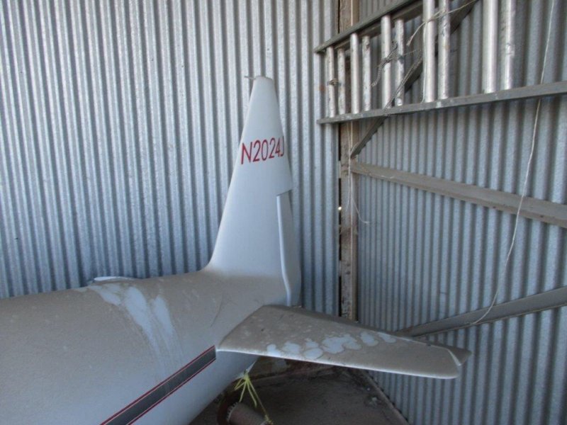

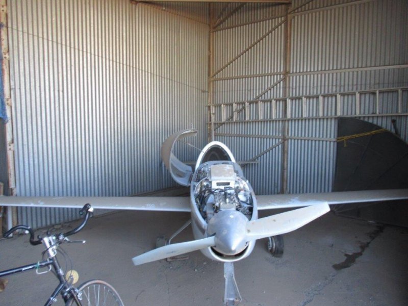

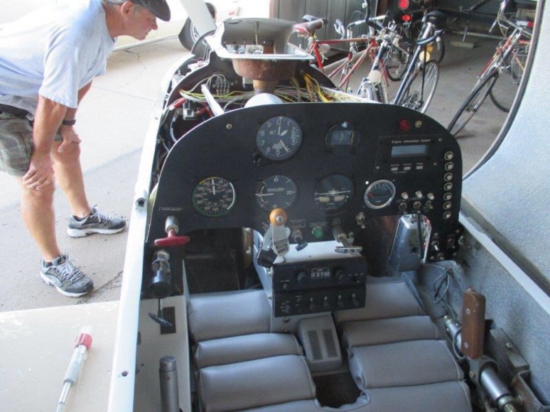

Did I mention that I bought another Lightning Bug during July? N2024J has been sitting idle for around 6 years in a hangar in Kansas. I have been trying to coax the owner into selling it to me for that time but he has been holding out on me. He finally relented and now it's mine.
The intention will be to use this Bug to test a new engine installation (the one I have under development as an alternative to the Rotax).
Here are a few pics of a very dusty N2024J. It'll scrub up nicely, I'm sure!

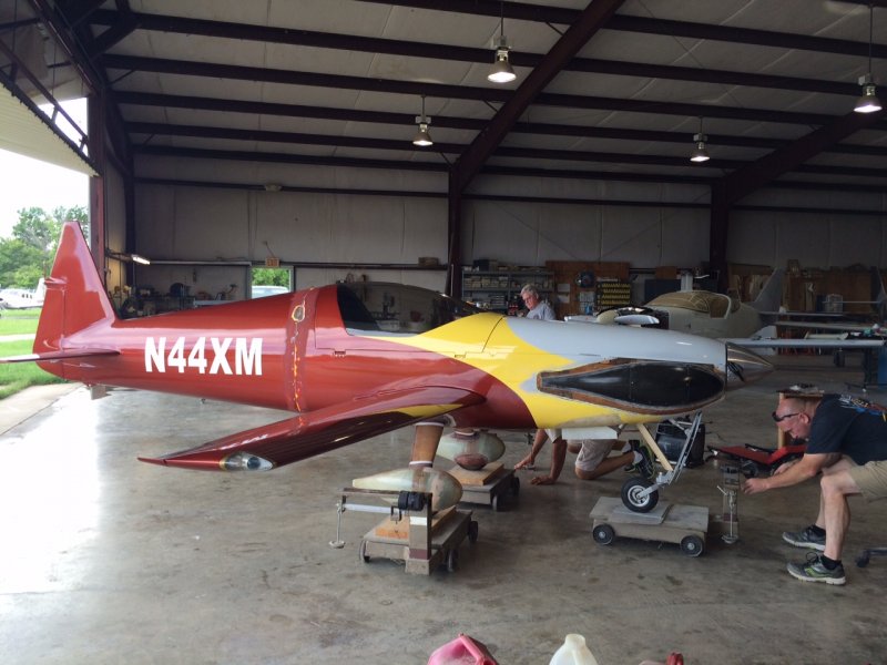

Two Bolly prop blades have just been delivered to Australian Lightwing to be fitted to their VIP2 IFA prop hub which will then be forwarded to Lanny for fitting to N44XM. We will then be able to test the aircraft with an IFA prop so we will anticipate seeing a much improved takeoff and climb, and hopefully a top end increase as well.
The aircraft will be painted to tidy it up cosmetically.
We would like to get it to Sunnfun but we need to make to make sure it is 100% ready for the cross country flight to get it there. If not Sunnfun, then definitely Oshkosh.
As we get performance figures with the new prop, I'll post them here.

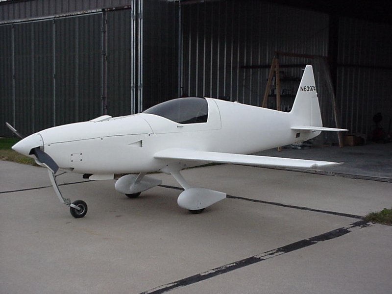

Hello, I built N63974. It had the 90hp engine if my memory serves me correctly. I added about 3-4 inches of height between the main gear and the lower fuselage to improve visibility during taxiing. That's why it has small fairings where the main gear meets the lower fuselage. I did not add the wheel fairings but it my opinion they make the airplane look even sleeker and surely improve speed. I've searched the web for the N# and it says it's been de-registered. Anyone know where it is? Thanks, John Gibbs
Hi John,
I spoke with you many years ago about your aircraft. I know where she is and I've got some photos of her current state which is a little worse for wear but certainly resurrectable with not too much trouble.
I'll pm you with my contact details. Drop me your latest email address and I'll give you all the details.
