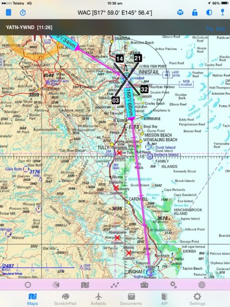

JUSTNUZZA Posted March 8, 2014 Posted March 8, 2014 Would like to know if anyone has problems printing paper back up plans on Ozrunways ? WAC charts will only print full a4 in complete black so you can not see anything and VNC will only print in landscape mode, in portrait it stretches an dis forms plans so the scale is unusable.
Russ Posted March 8, 2014 Posted March 8, 2014 I too are having problems with printing plans/ tables etc, contacted the folks, they are sorting the problem, keep an eye out for an update at the App Store. Bypassing the "print" option in oz, is easy.....take a screen shot, then print that....easy as. I take screen shots of my route, print them, then use them as my backup in flite....perfect. ( whatever is shown on your screen is what your printed backup shows ) Assuming you are using an iPad.??
JUSTNUZZA Posted March 8, 2014 Author Posted March 8, 2014 Russ, How did you get screenshots to print on full A4 size ? When I have tried printing them they come out only a but bigger than 1/4 of the A4 sheet.
JUSTNUZZA Posted March 18, 2014 Author Posted March 18, 2014 Found out how to print A4 screenshots. I downloaded a print manager app that lets you change paper size for printing.
DAVID SEE Posted March 25, 2014 Posted March 25, 2014 Bypassing the "print" option in oz, is easy.....take a screen shot, then print that....easy as. I take screen shots of my route, print them, then use them as my backup in flite....perfect.) Assuming you are using an iPad.?? Pardon my ignorance, but how do you take a screen shot and print it?? I'm not as familiar with this thing as the grandys are but they aren't here to show me 1
Peter008 Posted March 25, 2014 Posted March 25, 2014 I use "Printer Lite". It allows the iPad to print on the home computer via wifi. Have not checked why it is not to scale size as yet but that is the only issue I can see with it. Before finding that printer program on the net I would also do as suggested above. Do a screen shot (press on/off button and screen close button together) and email to the home computer and then print.
Russ Posted March 26, 2014 Posted March 26, 2014 I use "Printopia" same thing....wifi. Works perfectly.

metalman Posted March 26, 2014 Posted March 26, 2014 Bypassing the "print" option in oz, is easy.....take a screen shot, then print that....easy as. I take screen shots of my route, print them, then use them as my backup in flite....perfect.) Assuming you are using an iPad.?? Pardon my ignorance, but how do you take a screen shot and print it?? I'm not as familiar with this thing as the grandys are but they aren't here to show me David if you push the round button and the on/off button at the same time you should hear a noise like a shutter on a camera, have a look in your camera roll and it should have whatever was on the screen Matty
