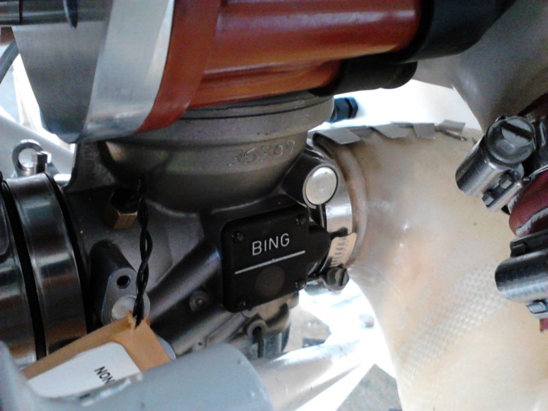

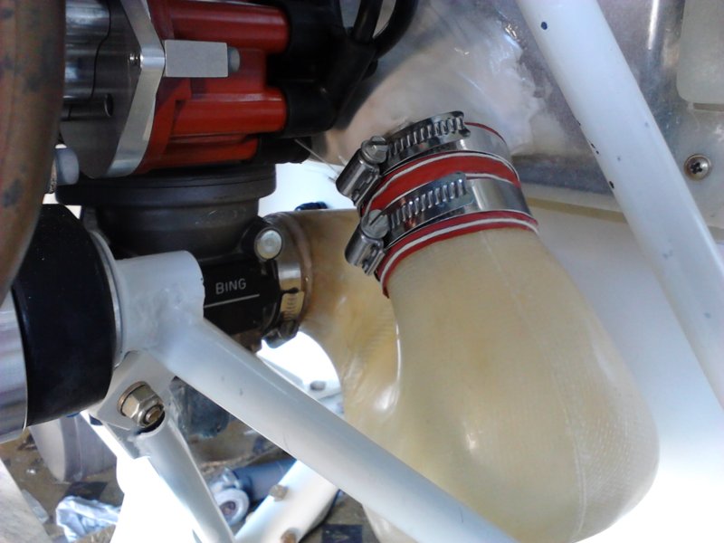

jetjr Posted December 11, 2014 Posted December 11, 2014 placing old gull wings underneath certainly stabilises temps. More resistant to changes and more even across each side. Between sides is harder, Im using a small fence to restrict air to RHS and bring temps up a bit......more trials needed but it is working I tried a inlet ramp into LHS duct, did bugger all 1
facthunter Posted December 11, 2014 Posted December 11, 2014 No-one tries (or few) angling the openings in the cowl at the front. They could account for prop rotational direction and angle of attack for low speed climb and ground operations in a T/W plane. Nev 2
kgwilson Posted December 11, 2014 Posted December 11, 2014 Quote placing old gull wings underneath certainly stabilises temps. More resistant to changes and more even across each side.Between sides is harder, Im using a small fence to restrict air to RHS and bring temps up a bit......more trials needed but it is working I tried a inlet ramp into LHS duct, did bugger all Are you getting an even mixture to both banks? A good Cobra head setup with a directive vane at the carb air intake can make a huge difference to differing temps on either bank. Garry Morgan has done a lot of trials & testing & what he has done works a treat on all Morgans. Here are a couple of pics of my setup as advised by Garry. The vertical vane can easily be bent one way or the other to get the temps even. The large Cobra Head provides smooth airflow & the vane is vertical, top to bottom & follows the curve of the Cobra Head. The vane is just a 3" long bit of 25 thou sheet inserted in a slot on the top of the Cobra Head. I have covered the tags with some gaffer tape to seal it. It takes about 5 minutes to remove and alter the vane.
dlegg Posted December 11, 2014 Posted December 11, 2014 Sonex sell a laser cut baffle kit for the Jab at US$250. Has anyone tried this out? http://www.sonexaircraft.com/eshop/cart.php?target=product&product_id=16561&category_id=335
aj_richo Posted December 11, 2014 Posted December 11, 2014 Its about the same amount of tweaking for a custom install using the fibreglass ducts as it for the metal. I would have preferred the later fibreglass type but the cowl is pretty tight over the front cylinders and much surgery would be needed I made the aluminium ones from scratch, pretty simple fabricate Mine is well within parameters in cruise, #3 can nudge 170C with hard climbs I have an air outlet behind the sump as well as the exhaust tunnels, this keeps air flowing over the sump and minimises hot air around the carb. The oil cooler air is completely separate from cowl air flow with is own NACA inlet and outlet is controlled by a cockpit controlled flap
jetjr Posted December 11, 2014 Posted December 11, 2014 I have 2 x vanes, first one helped, second one helped less Simple to do in fibreglass Remember IF these come loose they might ruin your day, take fitment seriously Gary does good work, the cobra head looks interesting, ive head a few engine experts suggest much larger volume upstream airbox might help. Re distribution accross banks, watch out talkng cht and fuel mixtures, egt does it better. I believe every jabiru should have full monitoring of both Yes EGT are fairly even at some parts of flight, wide spread at others. Hottest cylinder swaps around too. 170 is too hot, needs to fix that
aj_richo Posted December 11, 2014 Posted December 11, 2014 Quote 170c, you need to try and get that down, it's well and truly up there! Absolutely.. in cruise its around 100-110C. The RH Sonex inlet is hard up against #1 cylinder, in fact you have to trim fins to make the cowl fit. It is not great for getting a lot of air in there and it suffers in a climb attitude... especially steep climb angles but you can't see anything over the nose either, so you tend to climb shallower and clear the nose a lot... and for the record a Camit engine would have to same problems in a Sonex cowl. And you'd have to ditch the bigger alternator 1
