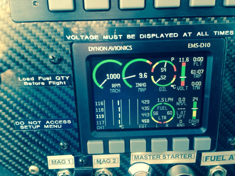

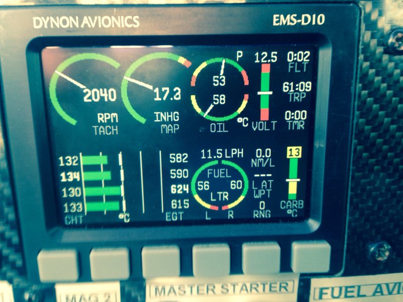

jetjr Posted April 8, 2014 Posted April 8, 2014 A key problem for Jabiru (and Camit I expect) is the inability to certify (or factory support) an ECU like this one. Means it would always be an add on for experimental use only, dramatically shrinking the market for it. Also chicken and egg, Ian would need to see a few running and get feedback people want it before investing effort $3500 parts, going to be ~$6000 fitted and thats a big step up for a $15-20 K engine too. My numbers reckon it will justify itself in fuel use alone pretty easily, plus extended life and maintenance benefits I have just seen some EGT numbers from a Camit engine and narrow spread is pretty impressive. Not sure whats been done in this area, there are some 3300 which just have good distribution. Shame mines not one of them.
Oscar Posted April 8, 2014 Posted April 8, 2014 JJ, absolutely correct, the hoops that have to be jumped through to get any form of certification are not for the uncourageous.. Your distribution problem is interesting, but of course totally known with Jab. engines. I think - but am in no way sure - that there were some tweaks to the intake plenum done some time ago, but again, Ian Bent will have the answer. Whatever HAS been done to get even distribution can't be just a one-off result, has to be repeatable - but the trick is, as always, knowing what has made the difference!
jetjr Posted April 9, 2014 Posted April 9, 2014 Yes none of the tweaks really worked very well, even higher cost like new plenums etc did little in sorting it out. Anything BUT repeatable! I did ask Ian a while ago but dont think he had achieved much either. I do know lots of hours has gone into sorting this problem out with little result. By design, having plenum end fed by basic carb isnt a good position to start with in getting even flows. Isnt a new issue auto makers struggled for years getting carb plenums and runners working right, if their R&D budget couldn't sort it out what hope does Jabiru or Camit have? Auto makers love multipoint EFI as many of these issues including average design, poor grade fuel, cold starts, altitude and hot weather problems just disappear. I still believe much of Jabiru failures can be linked to detonation and overtemp running. EFI solves much of it. 1
Oscar Posted April 9, 2014 Posted April 9, 2014 Yes, it's a PITA; with multi-point EFI and EGT monitoring mixture control, it should be possible to get very close to the button for all pots. If we didn't need to keep our beastie 55-reg I think I'd be looking at EFI right now; as I said earlier, the official (FAA etc.) attitude to electronic EFI seem to me to be based on 'possible' failure, rather than looking at the broader picture of relative likelihood of failure of the EFI in the context of the alternatives..
