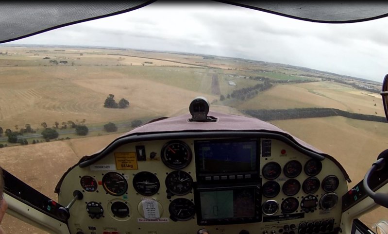

BlurE Posted March 17, 2014 Share Posted March 17, 2014 I have found a Gopro very useful during my training. I allows me to review each lesson and really reinforce what I am doing well and not so well. I also have time to think about and absorb instructions outside of the busyness of doing. (It's patched in to the intercom with a cable from skyshop so I can hear intercom and radio.) I have it mounted to the cockpit roof on centreline at head level and just behind my ear (fore-aft) It's set to the wide, (but not the ultra wide FOV) From this position the camera basically sees what I see. Instruments, stick position, and attitude of the nose. You can read the larger analogue gauges Tacho, ATL VSI IAS but the small gauges and glass display detail is too fine. I have also put a stack of graduated neutral density filters in front of the lens. These slow the shutter speed and blur out the prop so you don't get those stupid strobe stripe effects, and also helps to balance the exposure of inside and outside. As will all digital cameras the dynamic (light) range is much less that the human eye. Suction mount is about 90% reliable. It's dropped once or twice. I would use an adhesive mount were it my aircraft. It's been a really good investment for training. Do I expect to use it as much outside of training. No, it's not great entertainment. But maybe if I was flying somewhere interesting. 3 Link to comment Share on other sites More sharing options...
