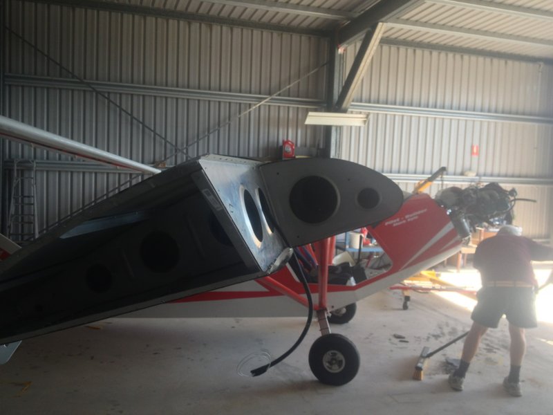

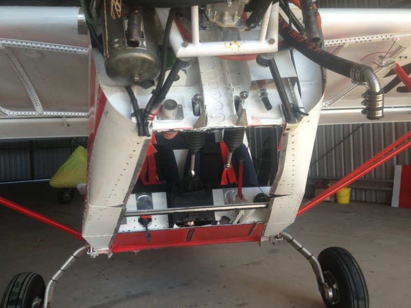

Kyle Communications Posted March 22, 2014 Posted March 22, 2014 You should be able to raise the nose of your Sav and rest it on its tail if it is balanced correctly when it is fully assembled. Even with the motor and everything ready to fly. Mine has just spent a couple of months like that while getting repaired and I had to put a new front floor and nose wheel in it
