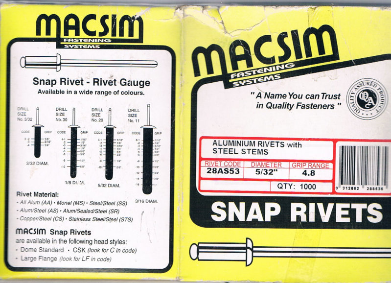

kgwilson Posted April 1, 2014 Posted April 1, 2014 I knew I'd seen it in some documentation but could not remember where until I looked on the box the rivets came in. As I said I use a 3/32 (2.38mm) drill for 3/32 rivets & the rivets always fit. I drill straight holes & use a hydro/pneumatic rivetter. See attached
Head in the clouds Posted April 1, 2014 Posted April 1, 2014 I knew I'd seen it in some documentation but could not remember where until I looked on the box the rivets came in. As I said I use a 3/32 (2.38mm) drill for 3/32 rivets & the rivets always fit. I drill straight holes & use a hydro/pneumatic rivetter. See attached[ATTACH=full]27832[/ATTACH] That's true enough - if you're using Macsim it really doesn't matter much what size you drill the hole because their rivets are 5052 alloy and they don't work harden very much at all. They're really only made for the building industry. Also, if you're using Macsim's you may experience a lot of failures (well I did when I tried them anyway) where the mandrel snaps off before the rivet has pulled properly tight and/or the back of the rivet splits rather than mushrooms ... I think it's worth considering the amount of work and money you put into assembling a kit and I really would recommend that you use a better quality rivet. Bremick's are an inexpensive alternative, they're only a few dollars more per thousand and as well as 5052 they also make a 5056 alloy which is approx 50% higher in both tensile and shear strengths, fatigue strength endurance is about 20% higher and they do work harden as you set them.
M61A1 Posted April 1, 2014 Posted April 1, 2014 I knew I'd seen it in some documentation but could not remember where until I looked on the box the rivets came in. As I said I use a 3/32 (2.38mm) drill for 3/32 rivets & the rivets always fit. I drill straight holes & use a hydro/pneumatic rivetter. See attached[ATTACH=full]27832[/ATTACH] All making sense now.....I've been talking about solid and cherrylock rivets.
