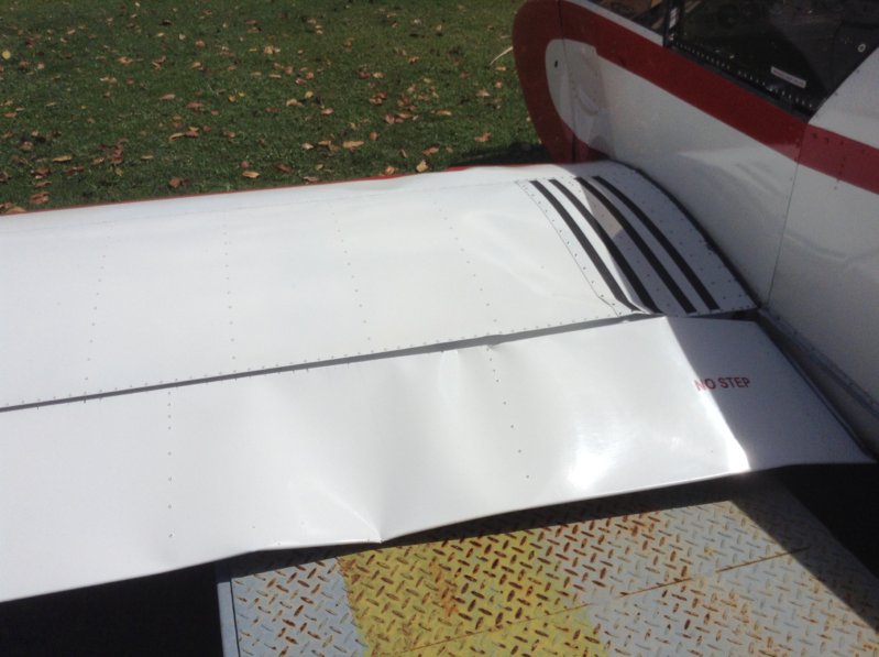

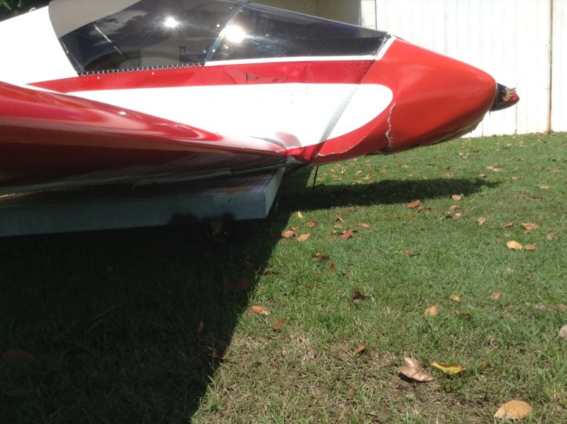

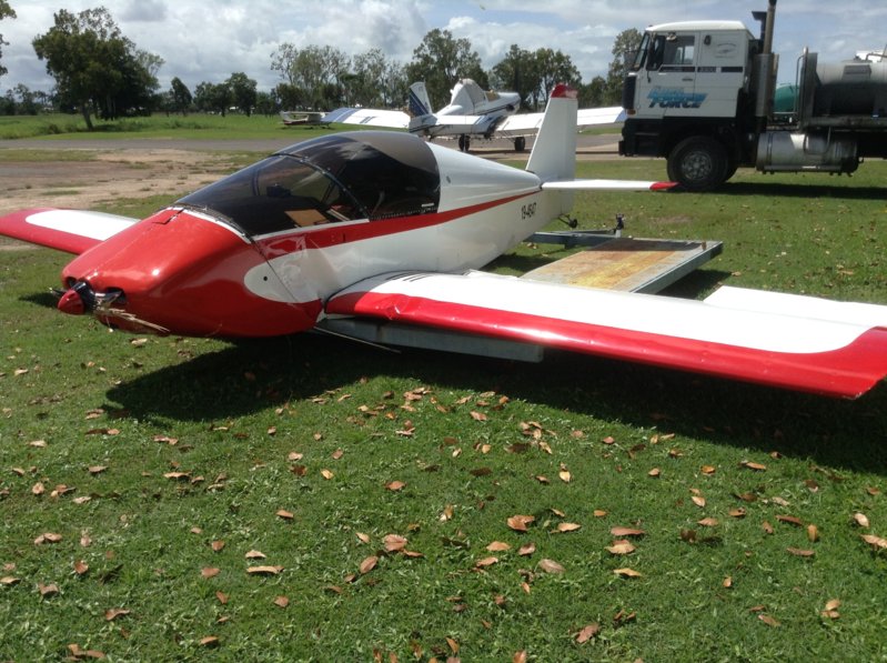

Appears Sonex taildragger 19-4647 came to grief during landing at Ingham in windy conditions on Saturday. The aircraft was purchased at Innisfail to the North, and was being flown South by the new owner, who suffered back injuries in what sounds like a stall/crash after a bounce, during landing. Aircraft appears it may be repairable, but damage is extensive...Pilot possibly with low taildragger time, engine VW based...........Maj....

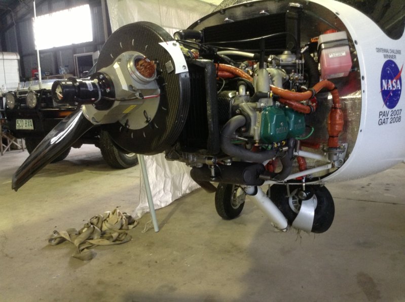

It was fitted with a fuel injected , turbo charged Aerovee 2180 cc donk. I hope the guy insured it before he crashed it.

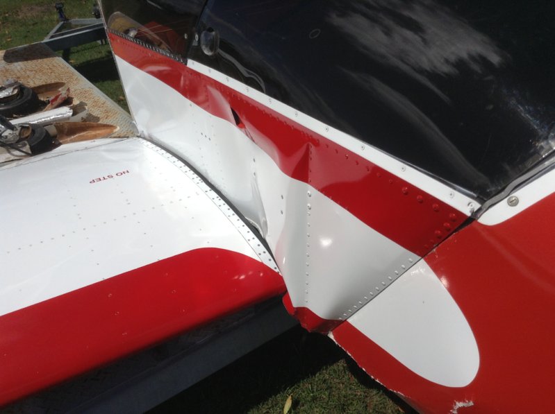

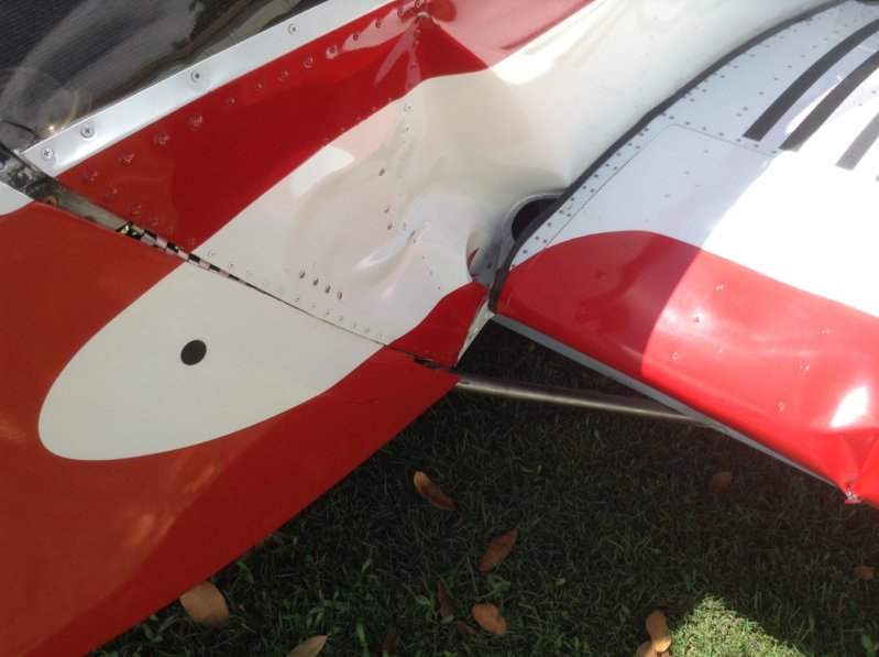

Ooo bugga, big job to fix. Sonex are built like brick poo houses but can be rebuilt. The plans are designed for scratch builders but I'd be worried about the main spars as they would be a bitch to rebuild if you had to import new spar extrusions.

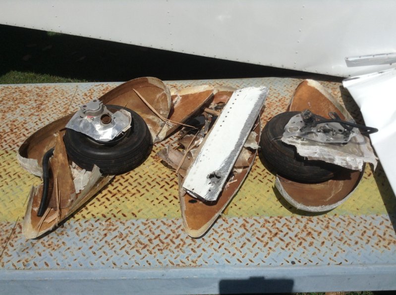

Pilots' people want a quote on pulling off the wings for truck shipment to Brisbane. Will look at what is involved in doing that tomorrow, and put her into the Aero club hangar for a huge rain event coming this weekend.

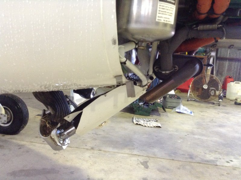

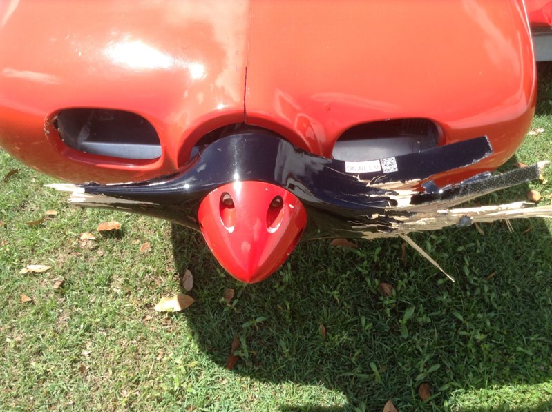

She will have to wait until after Natfly if I am to do it, but I'll do my best to help them out. Left wing looks like main spar damage and both wings have under surface damage caused by main wheels after they folded back under. Also obvious plane slid quite a way on asphalt which indicates a high landing speed attempt. Maybe somebody told him to fly her on, or maybe he was attempting a wheeler...always a mistake for a low timer. Threw a tarp over her today to keep the rain out of cockpit as dripping right onto instruments. Cockpit is well appointed. Da Ja vue for me as current repairing a Pipistrel Virus that suffered a similar fate a couple of weeks back...insured fortunately.........Maj.....
