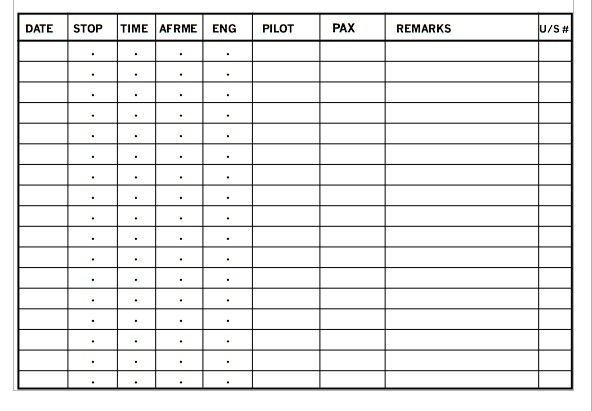

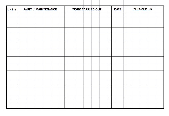

pylon500 Posted April 17, 2014 Posted April 17, 2014 Back in the 95:10 days, after I built my first U/L, I created my own flight and maintenance log to keep in the plane. Above is the log sheet part (didn't bother with landings then), the interesting bit is the last column where if anything went wrong, I marked a number (followed on from the previous number) that led me to; A maintenance log sheet (hopefully self explanatory). I printed about 4 log sheet pages to every 1 maintenance log. With the dodgy old 95:10's, I seem to make an entry every other flight, but eventually the flight times build up and the work load drops off. Naturally I keep a pilot log book as well..

spacesailor Posted April 21, 2014 Posted April 21, 2014 ?, What is VDO in the log, I know an instrument maker by that name, but surly you wouldn't use propriety names. spacesailor
Aldo Posted April 22, 2014 Posted April 22, 2014 VDO is the actual clock time from engine start to engine stop
metalman Posted April 22, 2014 Posted April 22, 2014 VDO is the actual clock time from engine start to engine stop Yeh, agree, VDO is sometimes called tacho time, the other method that is very rarely used by flying schools is air switch time, it doesn't read till you reach a certain airspeed, I've rented a Tigermoth that was on air switch ,and it was reading slow too :-) Matty

djpacro Posted April 23, 2014 Posted April 23, 2014 Tacho time may be used for aircraft maintenance times but it is not the same as "VDO" time as the tacho counter clicks over more slowly on the ground because of the lower RPM. 1
Downunder Posted April 23, 2014 Posted April 23, 2014 Tacho time may be used for aircraft maintenance times but it is not the same as "VDO" time as the tacho counter clicks over more slowly on the ground because of the lower RPM. Yes, I have tacho time and total (hobbs/VDO/whatever) engine time. Tacho time is less than total time.
