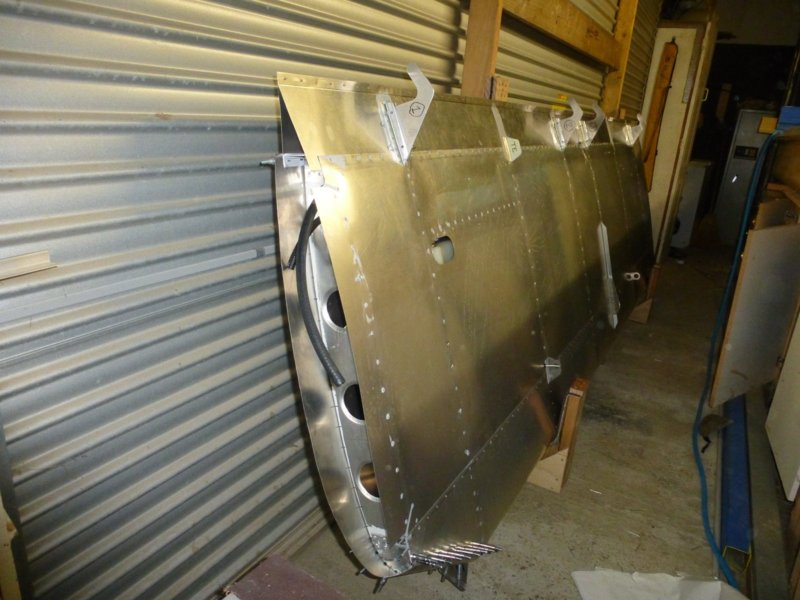

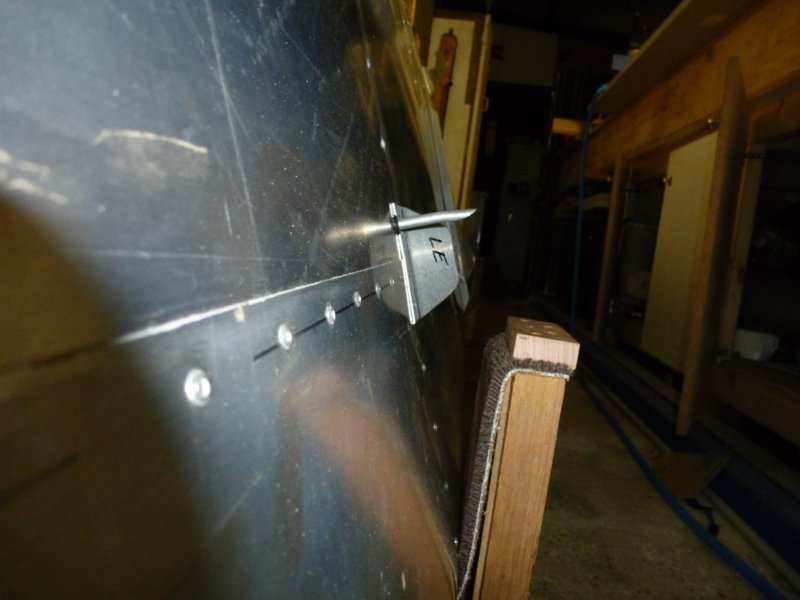

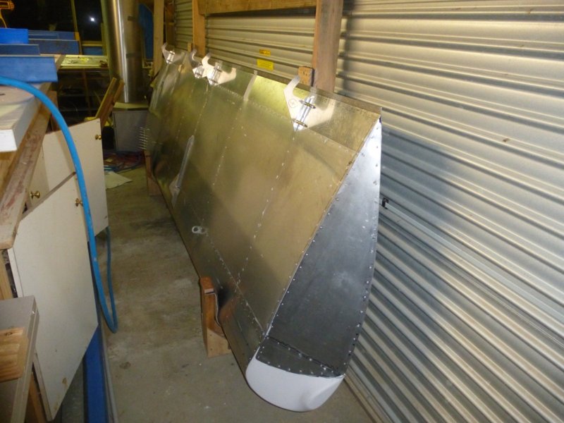

Marty_d Posted April 20, 2014 Posted April 20, 2014 Ok ok... I know I should have probably posted this in the aircraft forums, but dammit, I'm happy to reach this particular milestone! Everything done bar the root skin, which gets trimmed and riveted when attaching to the fuselage. And a couple of inspection covers, which will wait until I get some anchor nuts from Aircraft Spruce. The third photo shows the tank vent, which like the Sav plans goes from the filler cap through both skins and out the bottom. Difference is, I decided to use a piece of aluminium tube, the plastic vent tube supplied with the tank fits tightly inside. Workbench is now free for the second wing...
