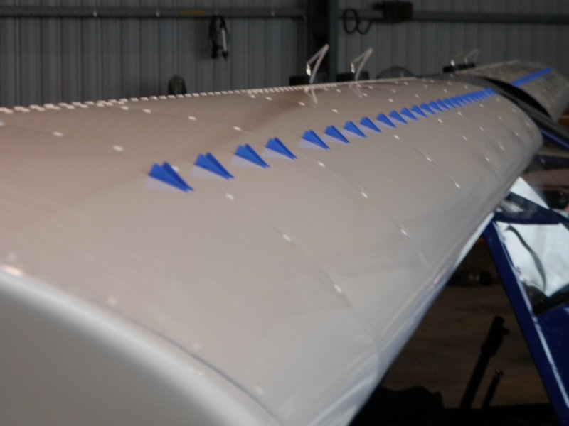

Old Koreelah Posted June 13, 2014 Posted June 13, 2014 OK. Please let me know how you get on. I fitted my new stall fences a couple of weeks ago, and have done one trip, but didn't have time to do stall tests until today. I followed Dafydd's suggestions (http://www.recreationalflying.com/threads/do-vortex-generators-really-work.117300/page-2) but made my fences a little larger. The biggest headache was doing major surgery to my carrier to accommodate the fences. The results- power-off stalls, with first stage of flaps: Without wing fence and stall strip: mushing at 41kt, losing 1000 fpm, then wing drop at 40kt. With wing fences and stall strips: a disconcerting nodding and tailwagging at 45kt, losing 800fpm, no stall or wing drop. Presumably the oscillating is caused by the tail being bumped between the fence vortices. The nodding behaviour may be a result of the elevator rythmically bouncing off from the turbulent air from the inner wing. Not the outcome I had hoped for; perhaps I can experiment with location of the stall strips
eightyknots Posted June 13, 2014 Posted June 13, 2014 I would advise you very strongly NOT to use VGs over the full span; read what I said in post #21 on this thread. Savannahs have full span VGs and seem by all accounts to have acceptable stall characteristics? Mine has had VGs added on the elevator. I took this picture of a Savannah S being assembled at Archerfield Aerodrome 18 months ago. You can see that the VGs are full-span. ICP also fits full-span vortex generator s to the XL and VG models. I understand that more than a thousand vortex generator equipped Savannahs are currently flying and, so far, I have not heard that the full-span arrangement has given any handling problems. Dafydd, why do you advise against full-span VGs?
Dafydd Llewellyn Posted June 13, 2014 Posted June 13, 2014 I fitted my new stall fences a couple of weeks ago, and have done one trip, but didn't have time to do stall tests until today.I followed Dafydd's suggestions (http://www.recreationalflying.com/threads/do-vortex-generators-really-work.117300/page-2) but made my fences a little larger. The biggest headache was doing major surgery to my carrier to accommodate the fences. The results- power-off stalls, with first stage of flaps: Without wing fence and stall strip: mushing at 41kt, losing 1000 fpm, then wing drop at 40kt. With wing fences and stall strips: a disconcerting nodding and tailwagging at 45kt, losing 800fpm, no stall or wing drop. Presumably the oscillating is caused by the tail being bumped between the fence vortices. The nodding behaviour may be a result of the elevator rythmically bouncing off from the turbulent air from the inner wing. Not the outcome I had hoped for; perhaps I can experiment with location of the stall strips You may be getting a kind of "falling leaf" effect, in which first one wing root separates and then the other - and it sets up a rythmic oscillation. I did warn that this might happen with a low-wing machine; with high wings, the initial stall spreads instantly from one wing fence to the other, so the whole centre-section stalls symmetrically, and there is no "tailwagging" effect. You may or may not be able to improve matters by adjusting the stall strips. I took this picture of a Savannah S being assembled at Archerfield Aerodrome 18 months ago. You can see that the VGs are full-span.ICP also fits full-span vortex generator s to the XL and VG models. I understand that more than a thousand vortex generator equipped Savannahs are currently flying and, so far, I have not heard that the full-span arrangement has given any handling problems. Dafydd, why do you advise against full-span VGs? [ATTACH=full]30838[/ATTACH] That can only mean, there is insufficient elevator authority to stall the wing, in the presence of the VGs. However, the elevator authority increases as the CG moves aft; do you have any idea where these aeroplanes are, in the allowable CG range? If there is sufficient elevator authority to stall any part of the wing, within the aircraft's permissible CG range, the stall is likely to be extremely vicious.
eightyknots Posted June 13, 2014 Posted June 13, 2014 That can only mean, there is insufficient elevator authority to stall the wing, in the presence of the VGs. However, the elevator authority increases as the CG moves aft; do you have any idea where these aeroplanes are, in the allowable CG range? If there is sufficient elevator authority to stall any part of the wing, within the aircraft's permissible CG range, the stall is likely to be extremely vicious. I am not sure, Dafydd. Perhaps owners of VG, XL or S model Savannahs would care to comment??
AVOCET Posted June 14, 2014 Posted June 14, 2014 Thanks, Tom. I'd use VGs on my own aircraft - but set up for the improved stall behaviour, not because of the numbers. What they do, is to make the full speed range usable. One of the demonstrations I have used in the Seeker, is to simulate a violent evasive manoeuvre - such as one might make if somebody were shooting at you - from 65 knots (the flaps-up stall speed being 56 knots): Boot full rudder, full aileron, stick on back stop and full power, to haul the thing into a tight turn. Any normal aeroplane would flick-roll from such treatment. The Seeker simply turns and keeps flying, with a barely-perceptible buffet from the stalled centre-section. The people marketing VGs are pushing the wrong aspect of them, in my view; used properly, they are a magnificent safety device. Used wrongly, they are bloody dangerous. I just wanted to explain that to people. what I would give to have dafydd living close by mike 2
