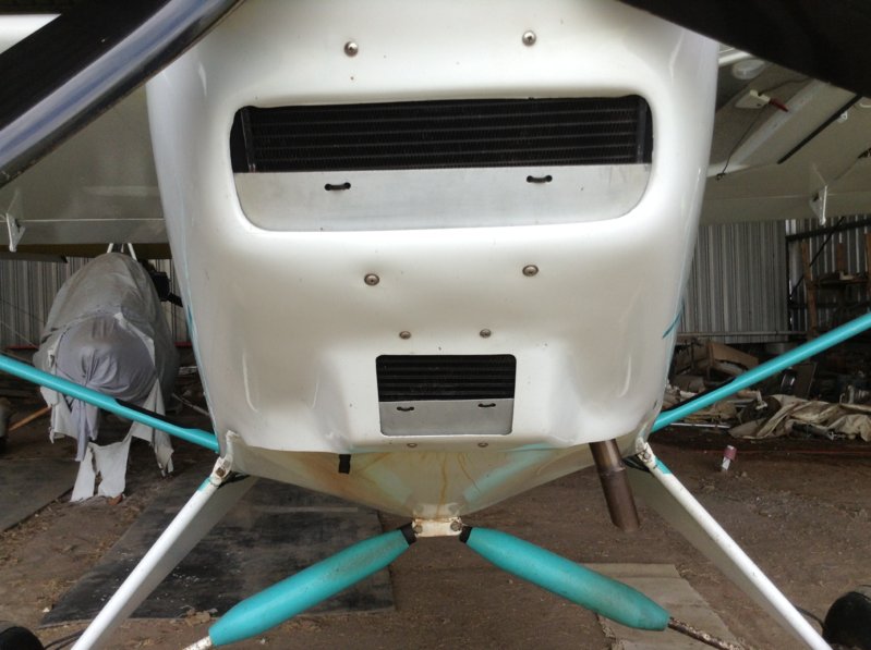

Guest Maj Millard Posted May 2, 2014 Posted May 2, 2014 The Evans won't keep the engine quite as cool but is doesn't boil and form steam pockets and running a bit hotter (with safety) is actually a good thing for these engines. With water/glycol based mixes keep the water as pure as possible for corrosion protection. Running on pure water for short periods if you have to won't damage anything unless your venting with a cap pressure that is a bit low or flying at high altitude (lower boiling point due reduces pressure and freezing). Nev My personal experience with the 912 is that they run too cool anyway most of the time, especially at cruise altitudes. I can't imagine why you would need a better coolant than the 50/50 Castrol Valvolene mix that I run in mine. Already operate with both oil and coolant cores 50% blanked just to say warm.......
