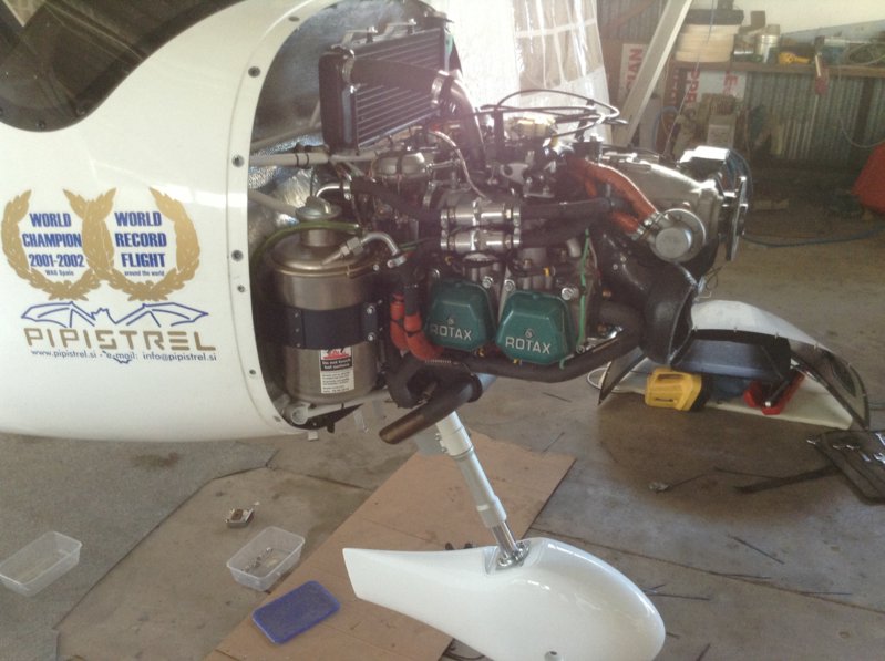

Guest Maj Millard Posted May 3, 2014 Posted May 3, 2014 Note;........Rotax has issued a service letter strongly advising against the use of any aftermarket equipment, modifications or kits on their engines. (SL 912-014).............Maj......
rankamateur Posted May 4, 2014 Posted May 4, 2014 Quote Note;........Rotax has issued a service letter strongly advising against the use of any aftermarket equipment, modifications or kits on their engines. (SL 912-014).............Maj...... Ross are you refering to thermostats not waterless coolant? I thought the most recent Rotax engines (Last two or three years) had an oil thermostat anyway.
Guest Maj Millard Posted May 4, 2014 Posted May 4, 2014 Quote Ross are you refering to thermostats not waterless coolant? I thought the most recent Rotax engines (Last two or three years) had an oil thermostat anyway. Referring mostly to thermostats....Evans is an approved coolant for the 912....not sure if oil thermostats are recently standard.....the Pipistrel I have just worked on has one, but not sure if its standard or not.....the Rotax service letter mentions many things, bring it up and have a read......................Maj....
