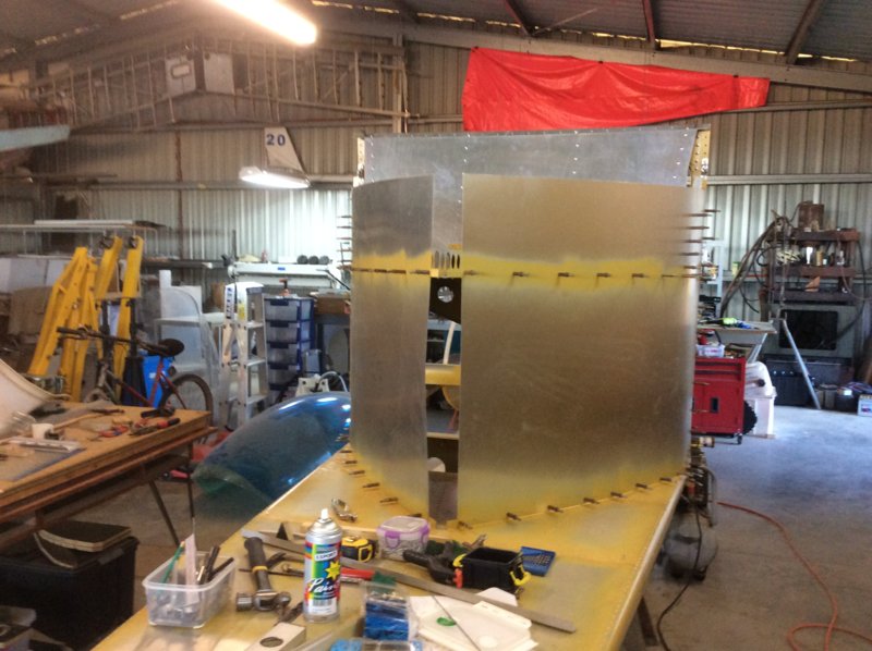

IBob Posted March 26, 2017 Posted March 26, 2017 [ATTACH=full]49541[/ATTACH] .......and a little further down the track Wow! Happy with the way it's coming? You should be...) 1
bexrbetter Posted March 26, 2017 Posted March 26, 2017 .......and a little further down the track Looks fantastic! 1
planet47 Posted March 27, 2017 Author Posted March 27, 2017 I'd like to be able to wiggle my nose and have it completed - 4 years of it is getting a bit much but thanks for the comments Ibob & bex 1
IBob Posted March 27, 2017 Posted March 27, 2017 I'd like to be able to wiggle my nose and have it completed - 4 years of it is getting a bit much but thanks for the comments Ibob & bex Yep, we hear ya....)
Head in the clouds Posted March 27, 2017 Posted March 27, 2017 Very nice work. Looking forward to seeing more ...

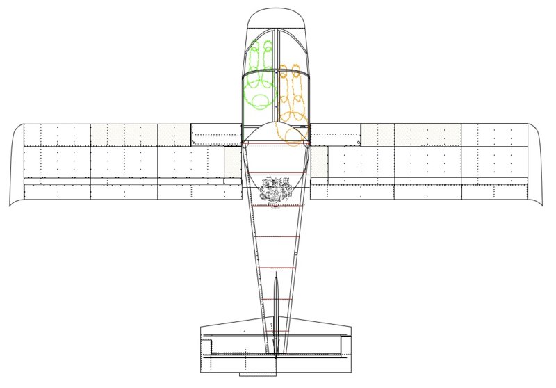

Marty_d Posted April 10, 2017 Posted April 10, 2017 Looking real good!! What's your rivet spacing on the longerons... 20mm?
planet47 Posted April 12, 2017 Author Posted April 12, 2017 Looking real good!!What's your rivet spacing on the longerons... 20mm? All is 1.1" in the area that is in the pic

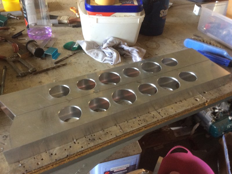

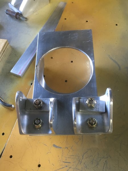

planet47 Posted April 14, 2017 Author Posted April 14, 2017 From 76 x 38 box aluminium with 2 different size hole saws on a mill about 4 hours later comes - the beginning of engine mounts. 3

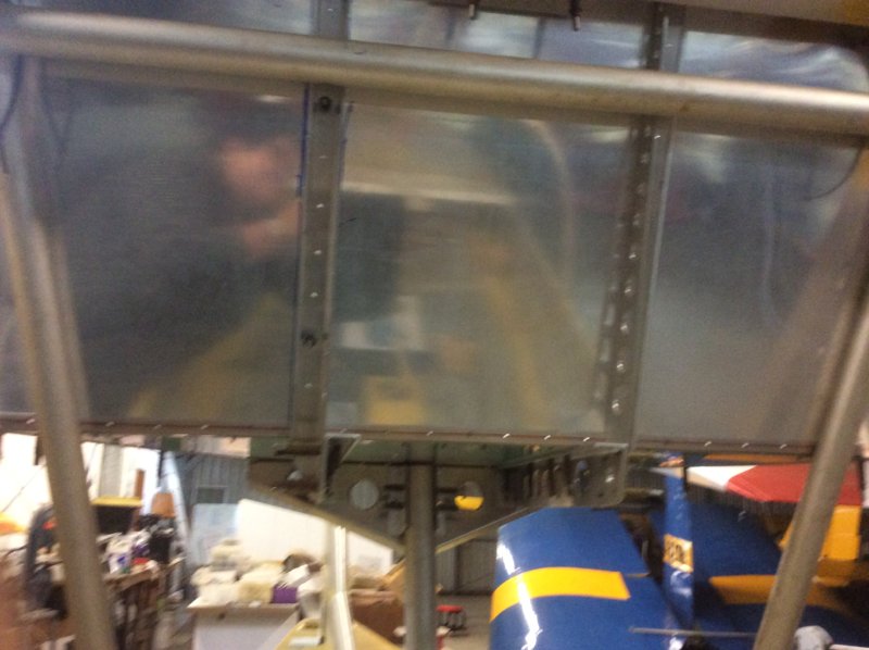

planet47 Posted October 7, 2017 Author Posted October 7, 2017 One day there will be legs & wheels One day I'll get to fly too!!! 2

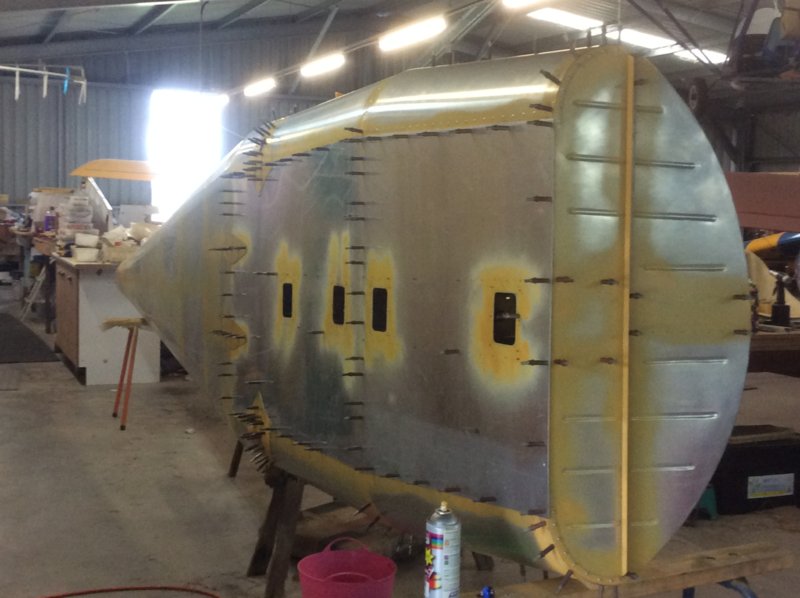

SSCBD Posted November 26, 2017 Posted November 26, 2017 Is that right hand top nut on correctly? Sorry to be picky. Just checking.
planet47 Posted November 26, 2017 Author Posted November 26, 2017 No - not yet anyway Just playing with it ATM

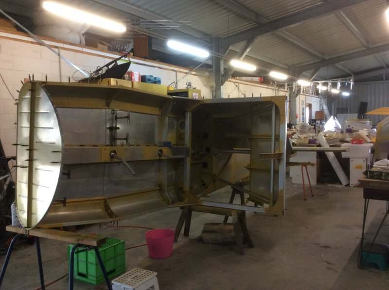

ClintonB Posted December 9, 2017 Posted December 9, 2017 With you dual controls and pedals spaced that way in the picture are you seating in tandem offset to the side? Just curious cheers clint
pylon500 Posted December 9, 2017 Posted December 9, 2017 With you dual controls and pedals spaced that way in the picture are you seating in tandem offset to the side? Just curiouscheers clint Generally referred to as 'staggered seating'. Not very common, but quite logical for a 'forward seated' aircraft. Mainly done for simplified CofG situations, shouldn't need to carry adjustment ballast. 2
