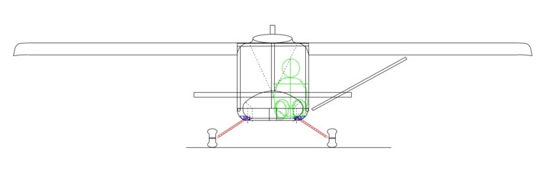

pylon500 Posted December 10, 2017 Posted December 10, 2017 Quote Side by side makes a fat plane sometimes but does simplify C of G issues. Only if you are sitting on the CofG, if you are sitting out front then side by side becomes a problem. Staggered gives you a few benefits; Narrower than full side by side, Usually no 1-up/2-up CofG problems, One instrument panel, Good pilot visibility, Plenty of shoulder room, Can still relate to your passenger. But, It looks a little weird, so people tend to shy away from it? Convention can be so hard to break away from.
facthunter Posted December 10, 2017 Posted December 10, 2017 It is probably a little unconventional. Yes the pilot (s) have to be near the C of G where they don't move it, but pushers have problems with falling on their tail when occupants get out if the wheels aren't a long way back then they fall on their nosewheels when landing.. Fuel location is the worst if it's not near the C of G as the balance point is then changing during flight. Depends on how simple you wish to make it. or whether you like a challenge. Nev
pylon500 Posted December 10, 2017 Posted December 10, 2017 Quote pushers have problems with falling on their tail when occupants get out Quote Fuel location is the worst if it's not near the C of G This will be a taildragger, with the fuel in the wings. It may not be painted gold? It will also have folding wings. 5

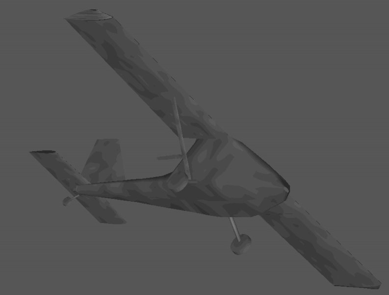

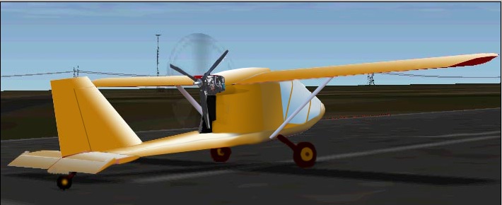

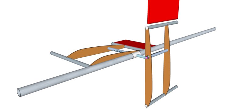

pylon500 Posted December 12, 2017 Posted December 12, 2017 Quote Front view Not quite. As a side by side stagger, it's going to be a bit wider, and have struts. Initial X-plane creation before colouring. 3 1
Head in the clouds Posted December 12, 2017 Posted December 12, 2017 Quote Not quite.As a side by side stagger, it's going to be a bit .... And also not a tricycle where you get out and it becomes a fall-on-its-ass ...
M61A1 Posted December 12, 2017 Posted December 12, 2017 Not to mention that the construction is completely different as well.....

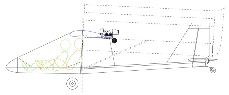

Deskpilot Posted March 13, 2018 Posted March 13, 2018 Pylon, sorry forgotten your name, anyway. your folding wing looks the same as I want to do with my Thruster. Care to show me/us how you intend to make the fold assembly? This is what I envisioned:

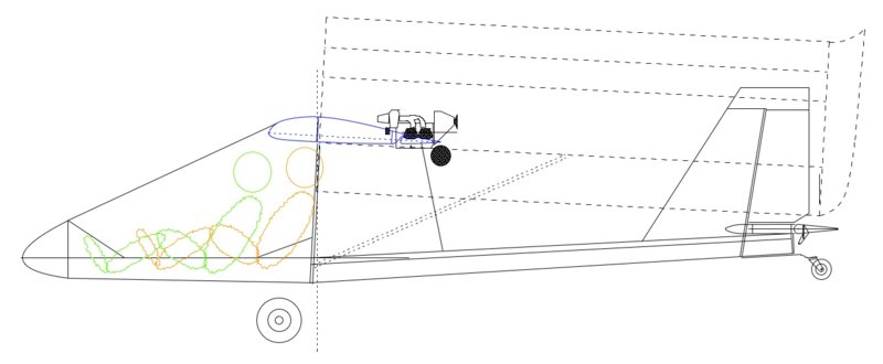

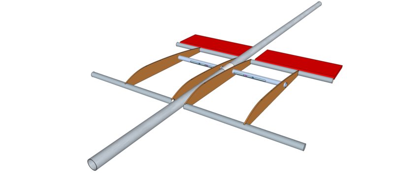

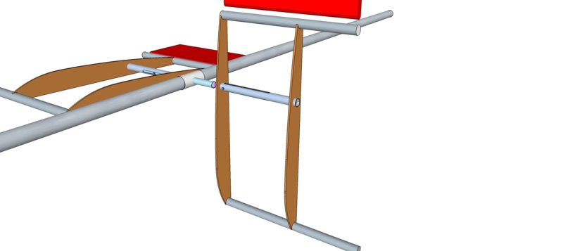

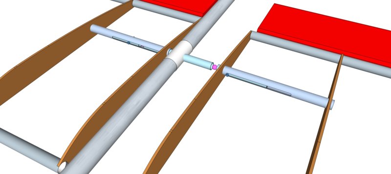

pylon500 Posted March 23, 2018 Posted March 23, 2018 Finally back from holidays... OK, the wingfold is the same concept, but done a bit different. It's an all metal wing with one strut. The wing has a single spar, and is attached to the fuselage by what is basically a universal joint. The strut is attached at to the wing via a rotating pin (a lot heavier than the Groppo Trail). The rear spar is attached via a remotely pulled pin which, after 'unsafetied', is operated from the wingtip allowing the wing to roll forward to vertical while still being supported by the strut. Then just swung back alongside the fuselage (will have some form of brace to hold it back). Nothing is disconnected, fuel tubes just flex with the wing and the flaperon rods go up with the wing, pushing the flaperons to the full 'up' position to give clearance for the prop.
Deskpilot Posted March 25, 2018 Posted March 25, 2018 Thanks mate. The Thruster, not having a 'main spar' becomes a bit more difficult. I will have to maintain the front and rear spar locking points and disconnect the struts at their lower end. I like your idea of a remote pin-pull but don't think I can incorporate it in my system.

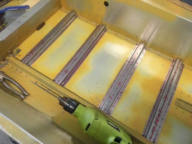

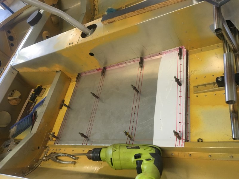

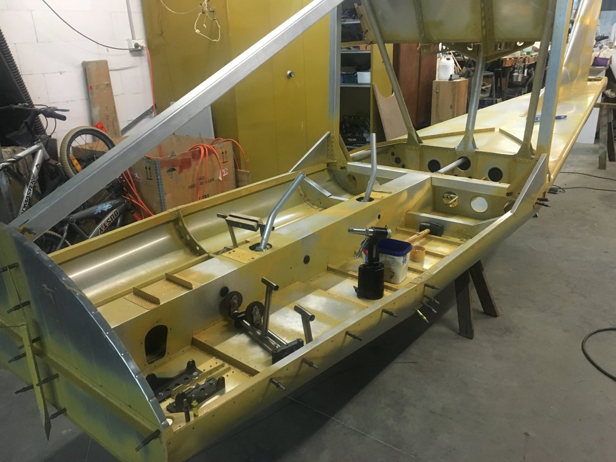

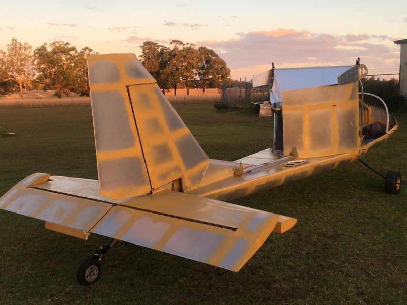

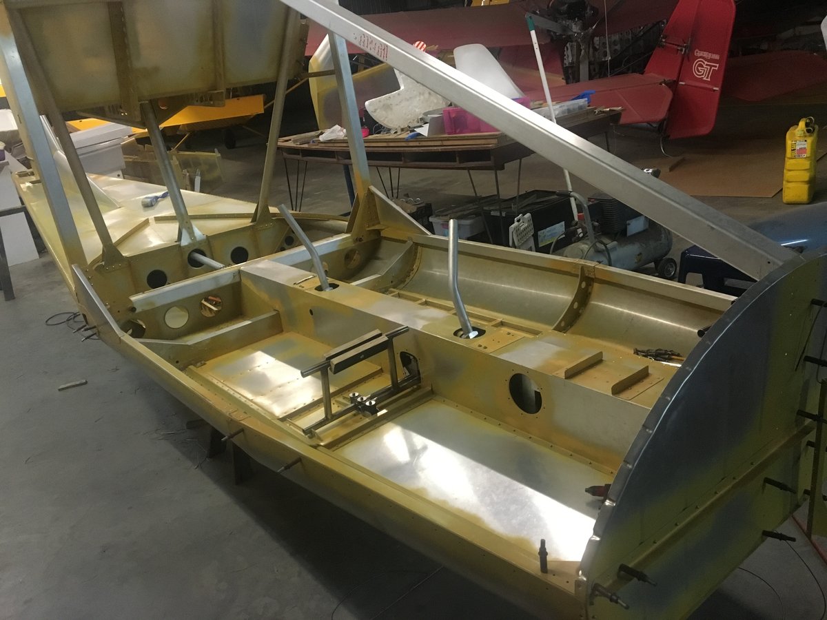

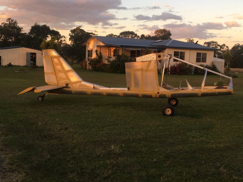

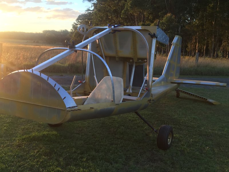

planet47 Posted May 26, 2018 Author Posted May 26, 2018 A couple more pictures and a little more progress
bexrbetter Posted June 16, 2018 Posted June 16, 2018 Absolutely fan bloody tastic, made my day seeing this! 1 2
planet47 Posted June 16, 2018 Author Posted June 16, 2018 Quote Absolutely fan bloody tastic, made my day seeing this! Thanks for your support bex 1
