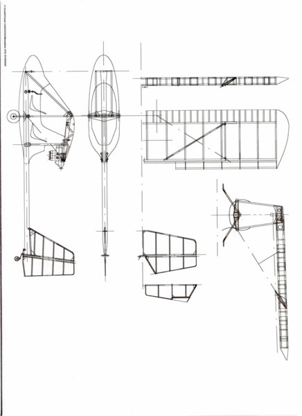

rotax618 Posted June 22, 2018 Posted June 22, 2018 Project is coming along well, but just looking at the elevation I can’t help thinking about the C/G without wing sweep. If you haven’t started the wing design yet I would encourage you to consider the possability. 1
rotax618 Posted June 22, 2018 Posted June 22, 2018 Would help a little if you move the engine forward and use the maximum prop extension. I am basing my opinion on my experience with my Boorabee design, which had a 2 stroke more forward under the wing, a lighter 1.6mmx 127dia tube boom and fabric covered tail. The Boorabee Rearward C/G was limited by a 70kg pilot sitting only slightly more rearward than in your drawing. I admire your concept but I would go back to the moment spreadsheet at this point you will have a pretty good idea of the moments of the remaining unbuilt bits. 1 1
pylon500 Posted June 23, 2018 Posted June 23, 2018 rotax618 re; During the initial design stage, the plan was to add a 4" extension on a 912, and possibly toy with a bit of sweep. As it was, an EA81 with an NSI gearbox was bought, so I'm currently trying to extract the spanner from the werks, and various changes are likely to be made. Current thinking is to do away with the NSI box, create an extension housing from the bell housing to carry an overhead shaft to extend probably around 12" aft, with a HTD belt reduction. And probably still some sweep back... Having a minor problem at the moment with having lost some of the drawings and the CAD program I was using when my hard drive died, you guessed it, hadn't backed up for a while

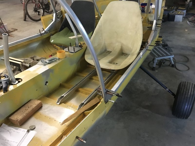

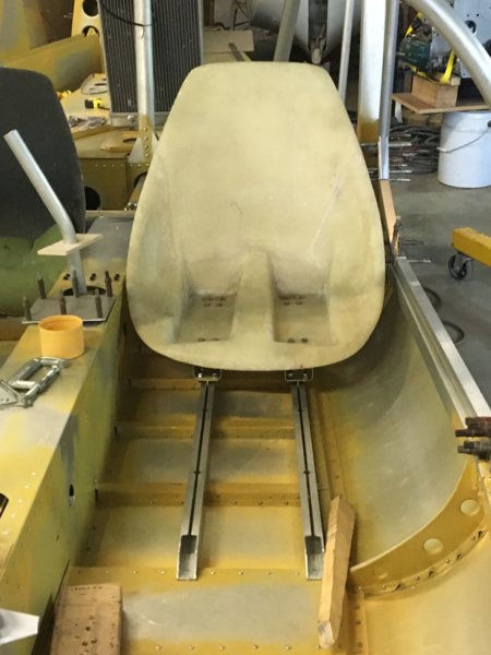

planet47 Posted October 13, 2018 Author Posted October 13, 2018 At long last the seat looks like it will finally work. I put the upholstered cover on it this morning and sat in it for a while as we pondered throttle cable & door latch placement 6
Marty_d Posted October 13, 2018 Posted October 13, 2018 At long last the seat looks like it will finally work. I put the upholstered cover on it this morning and sat in it for a while as we pondered throttle cable & door latch placement Tell me you made "vroom vroom" noises. I'm looking forward to the day when I can sit in mine and do that...
planet47 Posted October 13, 2018 Author Posted October 13, 2018 Vroom vroom and more vroom - also was time to consider what an instrument panel may end up looking like, consider less reflective colours/materials in the cabin area, using the stick, etc 1

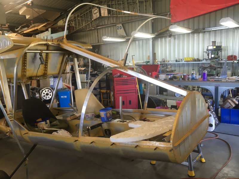

fly_tornado Posted November 2, 2018 Posted November 2, 2018 are you putting a gas stut on the door? from looking at my Tornado you need to secure door like that really well as they catch the wind and break the frames
planet47 Posted November 3, 2018 Author Posted November 3, 2018 Hey ya - there is a gas strut on it which is holding it open. You possibly can't see it for all the paraphernalia in the background.
fly_tornado Posted November 3, 2018 Posted November 3, 2018 just make sure that it doesn't snap the window frame if the wind gets under it
planet47 Posted November 6, 2018 Author Posted November 6, 2018 Evidence of gas struts fixed to doors 4
planet47 Posted November 7, 2018 Author Posted November 7, 2018 That's the one ClintonB - and here was I thinking of calling it the Flying Rivet 1
