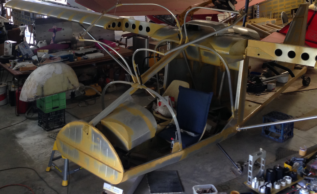

planet47 Posted November 19, 2020 Author Posted November 19, 2020 .......and after removing said plastic I get this 1

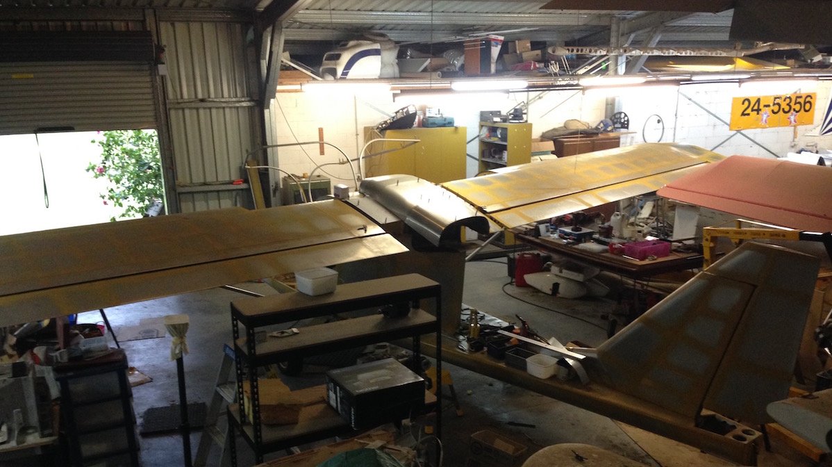

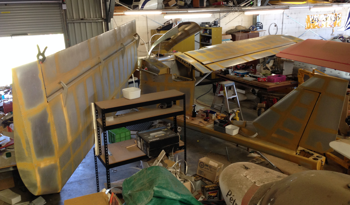

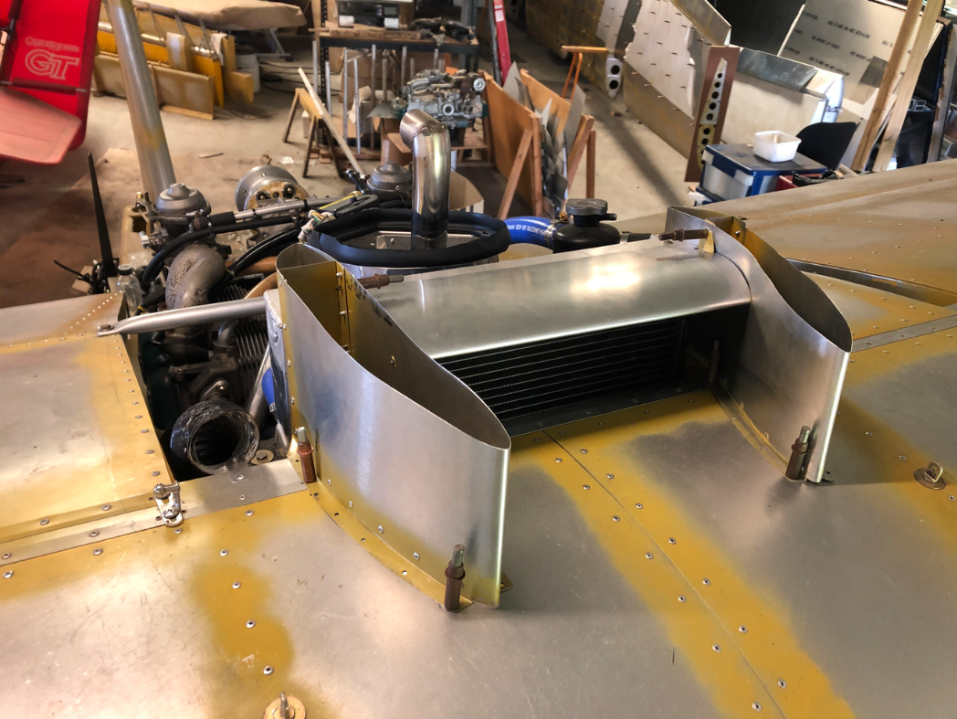

pylon500 Posted April 21, 2021 Posted April 21, 2021 (edited) Progress is slow, but happening. Just thought I'd throw this in for an update. As you can see from the second photo, space is at a premium.🙁 Edited April 21, 2021 by pylon500 3

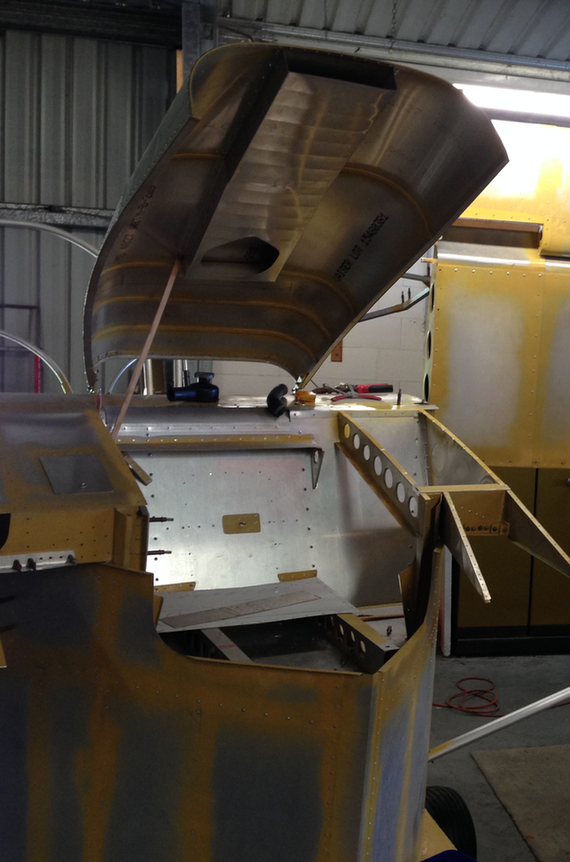

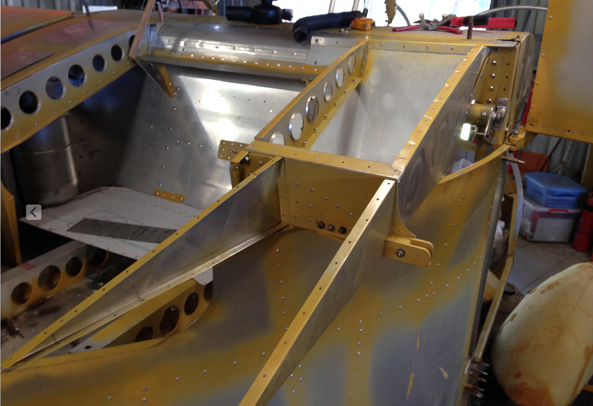

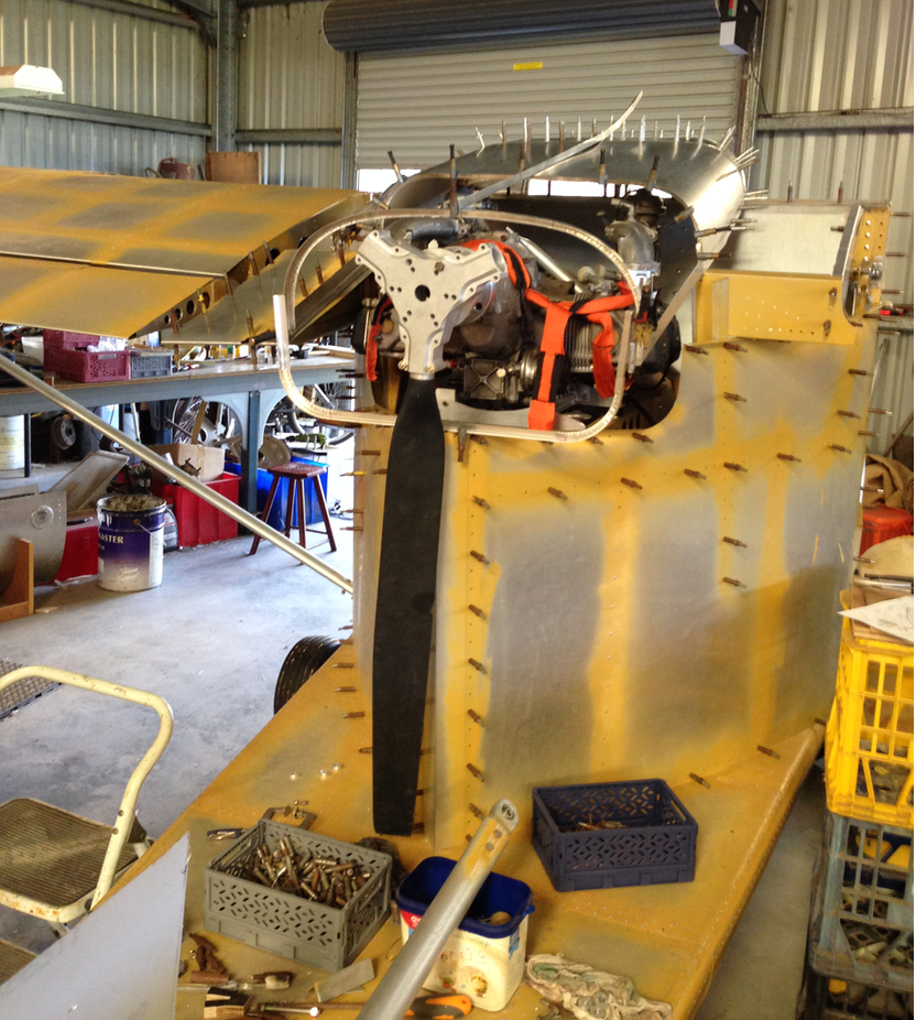

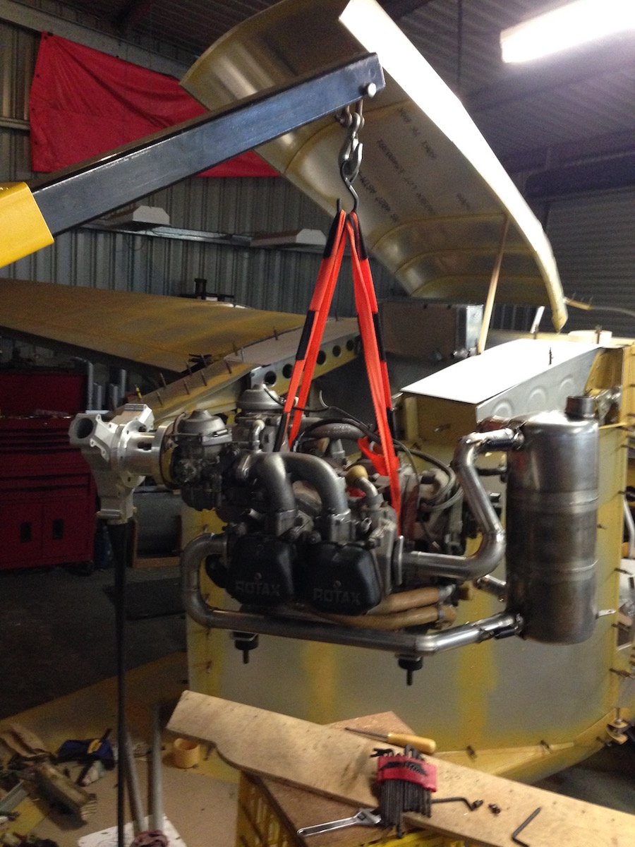

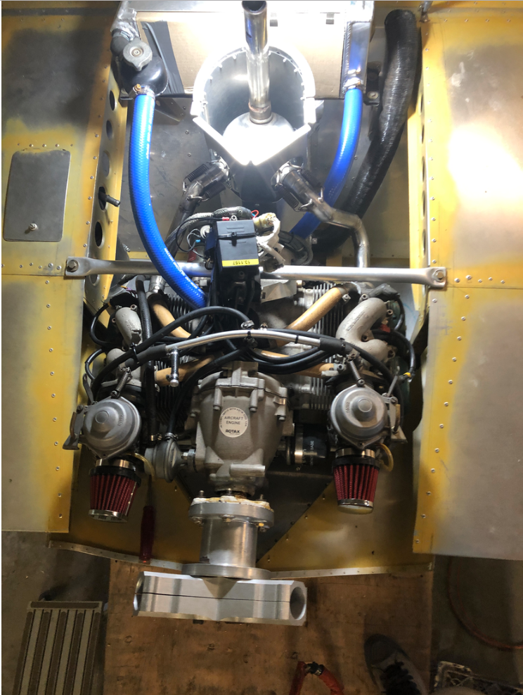

pylon500 Posted June 6, 2022 Posted June 6, 2022 Where does the time go! 😱 12 months since an update... OK, well, work is progressing, but it's mainly all the little fiddly bits that don't look like much when finished, and don't really inspire many photographs (that and the fact I keep forgetting to TAKE photographs!). Anyway, the engine is finally (I hope) in and assorted bits are being connected to it. This is a view looking down which basically shows some of my specialised design features. The muffler sits vertically in a semi-sealed container, which has fresh air fed to the bottom of it by the black foil tube. Hot air exits at the opening shown, into a duct built into the top of the cowling, which is scavenged by the prop. We can also see the secondary rear spar carry through (the aluminium tube), which is a backup to a U shaped spar arrangement running under the engine. The little hatch on the left leads to the oil tank. Here is an (earlier) view of the top cowl showing the exhaust shroud duct. This does NOT carry the exhaust, that exits out through the top of the cowl, this is just the hot air around the muffler, being diverted so as not to flow down over the engine. This is part of my plenum system to smooth airflow both through the radiator, and around into the engine bay. The black tube to the exhaust box visible on the left. This makes more sense when the cowl is shut, but hard to photograph. The front of the cowling is not as prominent in this photo, and this was taken before the plenum airfoils were fitted. I guess I should take some more photos... 4 1
Old Koreelah Posted June 6, 2022 Posted June 6, 2022 Just happened on this thread, so the actual layout of the plane baffles me. More pix please, or even a video.
