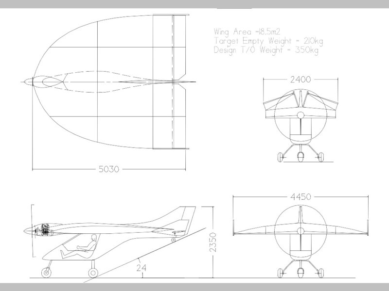

rotax618 Posted May 14, 2014 Posted May 14, 2014 I have found using models that an inverse zimmerman planform has a better L/D than a circle. 1 1
rotax618 Posted May 14, 2014 Posted May 14, 2014 The attached is a sketch of a possible low aspect simple aircraft. I placed the pilot below the wing to address the access, visibility and undercarriage length problems associated with this planform. I admit that it would be better looking and more efficient to sit in the wing, with transparent floor and retract U/C. 1
gimballock Posted May 14, 2014 Author Posted May 14, 2014 The attached is a sketch of a possible low aspect simple aircraft. I placed the pilot below the wing to address the access, visibility and undercarriage length problems associated with this planform. I admit that it would be better looking and more efficient to sit in the wing, with transparent floor and retract U/C. Yes, I recall that you said that you prefer the "Inverse Zimmerman" planform. Rowe's aircraft is *almost* an Inverse Zimmerman, but looking at the fly-by on the video, it's equally clipped at the front as well as the back. Have you considered building a full-scale version of this? I'd love to see any experimental aircraft of these kinds actually built and flown. Thanks.
bexrbetter Posted May 14, 2014 Posted May 14, 2014 It's a standard aerofoil with a reflex (as all flying wings/tailless aircraft are.) . What "standard" airfoil is it and what does "reflex" mean relative please? Thanks for going to this effort as well! I have found using models that an inverse zimmerman planform has a better L/D than a circle.I placed the pilot below the wing to address the access, visibility and undercarriage length problems associated with this planform.] That looks terrific and I was actually going to ask why every flying wing I see has the fuse on top, yours seems much more logical layout. Why would you not fold the wing ends down on that?

rotax618 Posted May 14, 2014 Posted May 14, 2014 To see the sketch can be viewed by clicking the thumbnail on my previous post. I would need to build and fly more larger scale models of the concept, alas I am limited by my health these days.

gimballock Posted May 14, 2014 Author Posted May 14, 2014 To see the sketch can be viewed by clicking the thumbnail on my previous post. I would need to build and fly more larger scale models of the concept, alas I am limited by my health these days. Sorry to hear that your health is a problem, Rotax. That's a fear that we all live with. Where are you located? 1
gimballock Posted May 15, 2014 Author Posted May 15, 2014 To see the sketch can be viewed by clicking the thumbnail on my previous post. I would need to build and fly more larger scale models of the concept, alas I am limited by my health these days. Your design looks a lot like the Sukhanov Discoplane: I think that this design has it merits.
