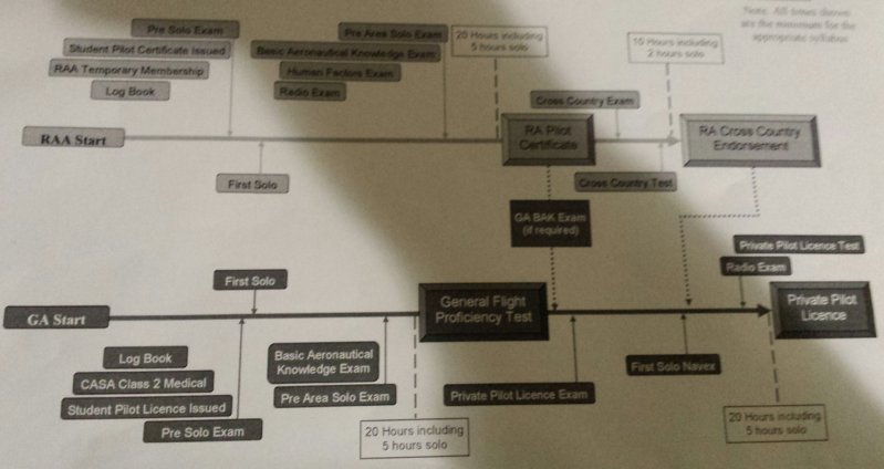

20140609_181711-1.jpg.6395c2bd44130da8e826550dbfc48136.jpg In the process of doing it now.
And have heard wispers that an ra certificate with a XC endorsement might be enough to bypass the BAK (given inital theory was good enough).
Dont know what merit it has but could be a definate time save, as long as the flight school is happy with the level of theory.

That's pretty much how I'm doing it. I did not have to do the GFPT, and the BAK I took was good enough - they just needed to see it in the logbook in the testing centre prior to sitting the PPL(A). You need to KNOW all of it for the test tho!! I don't know if it saved me time, but I am sure it saved me money. I think any time i'd have saved was sucked up by weather delays and bureaucratic paper shuffling once I started applying for my medical etc.... but yes, do make sure you are in an RAA school that teaches to the Day VFR syllabus, and you'll be right.
