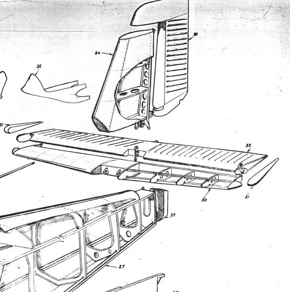

djpacro Posted June 11, 2014 Posted June 11, 2014 Cooda, unable to get anything from CASA's defect database online but I can provide contact details for some one who knows. He also landed with rudder locked at a large deflection. I don't recall exactly what bit and the diagram is not detailed enough to suggest what it may be (from memory, right at the back of the fuselage).
