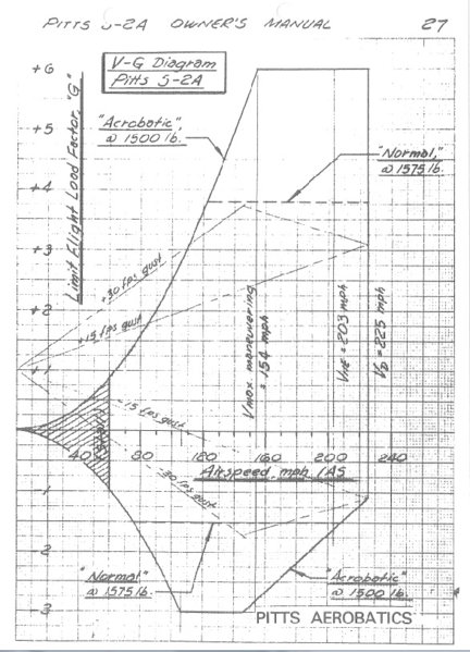

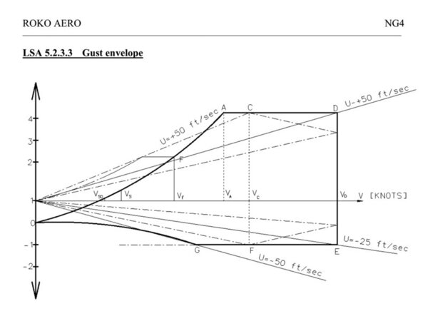

Dafydd Llewellyn Posted July 2, 2014 Posted July 2, 2014 From FAR 23.335: © Design maneuvering speed VA. For VA, the following applies: (1) VA may not be less than VS√ n where— (i) VS is a computed stalling speed with flaps retracted at the design weight, normally based on the maximum airplane normal force coefficients, CNA; and (ii) n is the limit maneuvering load factor used in design (2) The value of VA need not exceed the value of VC used in design. (Note: Vc is the speed at which the aircraft is designed to meet the 50 ft/sec gust requirements. Some "simplified" recreational aircraft standards do not use it. and Horizontal Stabilizing and Balancing Surfaces § 23.421 Balancing loads. (a) A horizontal surface balancing load is a load necessary to maintain equilibrium in any specified flight condition with no pitching acceleration. (b) Horizontal balancing surfaces must be designed for the balancing loads occurring at any point on the limit maneuvering envelope and in the flap conditions specified in §23.345. [Doc. No. 4080, 29 FR 17955, Dec. 18, 1964, as amended by Amdt. 23–7, 34 FR 13089, Aug. 13, 1969; Amdt. 23–42, 56 FR 352, Jan. 3, 1991] § 23.423 Maneuvering loads. Each horizontal surface and its supporting structure, and the main wing of a canard or tandem wing configuration, if that surface has pitch control, must be designed for the maneuvering loads imposed by the following conditions: (a) A sudden movement of the pitching control, at the speed VA, to the maximum aft movement, and the maximum forward movement, as limited by the control stops, or pilot effort, whichever is critical. (b) A sudden aft movement of the pitching control at speeds above VA, followed by a forward movement of the pitching control resulting in the following combinations of normal and angular acceleration: ------------------------------------------------------------------------ Normal Condition acceleration Angular acceleration (n) (radian/sec2) ------------------------------------------------------------------------ Nose-up pitching............... 1.0 +39nm÷Vx(nm-1.5) Nose-down pitching............. nm -39nm÷Vx(nm-1.5) ------------------------------------------------------------------------ So Va is a number of things: Firstly, it's the highest speed at which the wing can be pulled to stalling incidence, in longitudinal equilibrium (i.e. by steady application of the controls) without exceeding the limit load. Note that the wings will be carrying n times the aircraft weight PLUS whatever download is necessary at the tailplane to hold that flight condition. Secondly, it's the highest speed at which any ONE control surface may be abruptly deflected to its stops (momentarily) without overloading the control surface or its support structure or the control system. However, it is still possible to overload the airframe at Va if the aircraft encounters a gust load at the same time as the manoeuvre load; and also by deflecting more than a single set of controls simultaneously. Further, the aircraft has to be strong enough to withstand this load only ONCE in its life.

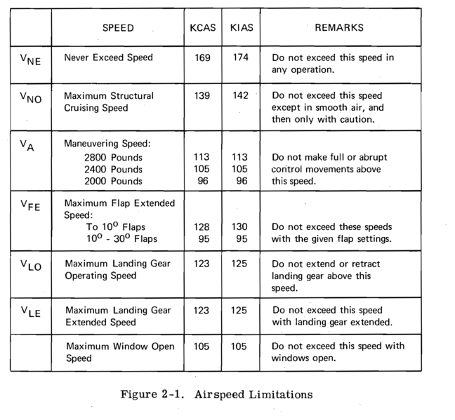

Guest Nobody Posted July 2, 2014 Posted July 2, 2014 Va is always calculated for the MTOW - so only one value. Extract from Cessna 172s POH
DWF Posted July 2, 2014 Posted July 2, 2014 Va is always calculated for the MTOW - so only one value. Not always! From the C177RG POH
