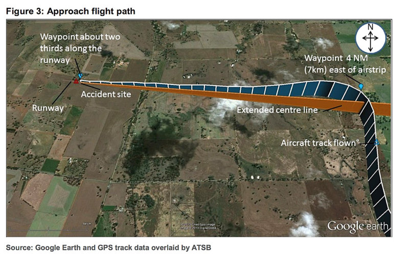

Reading the docs he used a GPS waypoint for his final turn point and then just headed towards the headlights. Bad plan

please show me where it says gps waypoint was mentioned

This is where the gps waypoints are mentioned in the ATSB report
(ATSB – AO-2013-104 Final 30th June 2014 - p4-5):

The recovered flight information included the aircraft’s speed, track, altitude and a number of engine parameters. The flight data also included a number of waypoints, including one on the extended runway centre-line about 4 NM (7 km) east of the airstrip, and another about two thirds along the runway (Figure 3).
The recorded data showed that at 1806:08 the aircraft was at 1,600 ft above mean sea level on a northerly heading on what appeared to be a base leg. The aircraft was then turned onto about 267° for the final leg of the approach. The aircraft was flown through the 4 NM (7 km) waypoint before the turn, which positioned it to the north of the extended centre–line. This required a number of heading corrections by the pilot to regain track to the final waypoint. The aircraft maintained a steady descent path and airspeed of 93 kt toward the last waypoint.
