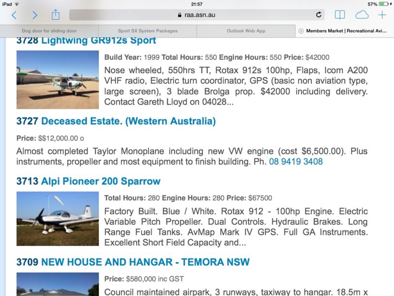

There's a project for sale in WA at the moment. It's on the RAAus members market. You could get a real head start.
Cheers,
Dave
