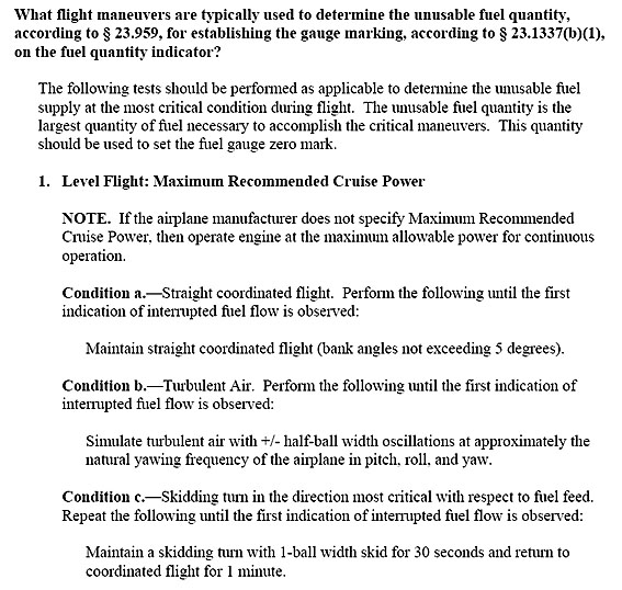

Dafydd Llewellyn Posted August 19, 2014 Posted August 19, 2014 Looking at the POH from the Jabiru website, the J 170D has an "all on" fuel system, using two long wing tanks plus a collector tank. The POH gives the usable fuel as 135 litres, and shows the unusable fuel as 5 litres. The normal method of determining the unusable fuel is given in FAA AC 23.16A ; attached is an extract. These tests are normally used in my experience, regardless of the aircraft category. Therefore, it would follow that the normal expectation of a certificating authority is that uncoordinated flight will not normally be sustained for more than 30 seconds at a time. 1 1
