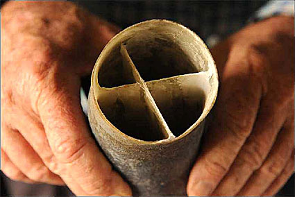

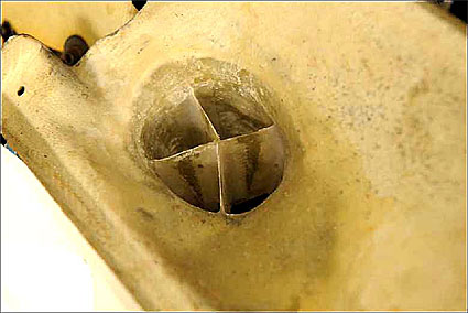

aj_richo Posted August 15, 2014 Posted August 15, 2014 a mechanic at tyabb has solved the cooling problem and their is a picture of his 3300 install in the RAA magazine a few monthes ago of the Bristell with a jab enginehe build a proper plenum chamber like a Cessna I heard recently from someone who contacted Bristel to get info on their cooling setup.. they said they had gone back to jabiru cooling ducts. 1
