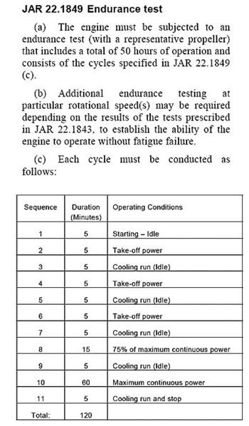

Dafydd Llewellyn Posted August 6, 2014 Posted August 6, 2014 FFS the better question is why is there any need to do this on a certified engine FFS. Routine maintenance. Being certificated (NOT certified) does not remove the necessity for maintenance. The fact that it's necessary suggests that the valve guide temperatures are a bit on the high side - which again says that the CHT is getting a tad higher than was demonstrated during the 50 hour certification endurance run. The temperature limits given in the TCDS are based on the temperatures that were exceeded for at least 50% of the endurance run; that's how they were established in the first place. The engine has to be run for 25 2-hour blocks, during the first hour of which the power is varied from idle to takeoff power; and the second hour is held at maximum continuous power, and red-line temperatures. CASA sits-in on all such tests. The engine is stripped and inspected afterwards, and carbon build-up in the guides would have been seen - so one must therefore deduce that if they are carboning up in service, then the CHT and/or the EGT are exceeding the TCDS limits. Hence my comments re the cold junctions. I don't think you are correct re Lycomings etc; it doesn't have to be done frequently, but those air-cooled engines all run very close to limiting conditions for the exhaust valve guides. Continental has gone through about four changes in exhaust guide material over the years, and they still give trouble. The Rotax has liquid-cooled heads, whose main advantage is that they make it easier to cool the exhaust guides. Some Lycomings have oil passages in the head to try to reduce the guide temperatures; I hate to imaging what the maintenance issues are when those passages carbon up, as they must. Cars don't do it because they do not run the same duty cycle as an aero engine. 1 1

Dafydd Llewellyn Posted August 6, 2014 Posted August 6, 2014 In the interests of a better general understanding, here's (part of) what it takes to type-certificate an engine for a recreational aeroplane: The temperature limits given in the engine TCDS (look it up on the CASA website) are determined as a result of this test. 1 1

David Isaac Posted August 6, 2014 Posted August 6, 2014 Um - your reasoning is a bit garbled, I think.If you are demanding This means, you do not have a proper understanding of what Type certification is all about; and that is a general problem throughout the aviation industry, I'm sorry to say. Most people understand that a pilot needs to comprehend that if he exceeds the flight envelope limits, he can pull the wings off. Similarly, if he exceeds the certificated operating conditions for the engine, things can come unstuck there also. I am NOT trying to put all the blame onto the operators of Jabiru engines; but please get your facts straight. Firstly I am absolutely not saying that "the design of the engine and the design of the aircraft should be such that no matter what the operator does, it's impossible to exceed limits, you are demanding more than the certification standards call for." I have no idea how you would deduct that from what I said. I have been flying GA aircraft since I was 16 years old and operated C180s, 182s, 185s, 206s all with cowl flaps and I understand operating engines properly and I have an extensive knowledge of what goes on internally in an engine and the issues surrounding operating temperature. I did say "exceeding certificated temperatures in normal use and application..." and by that I mean operating the aircraft normally as in accordance with the POH. Just to clarify that I do not consider I am ignorant on these issues. If you operate the aircraft in accordance with the POH (normally) there should not be over temp issues unless the PIC is asleep. 4
Dafydd Llewellyn Posted August 6, 2014 Posted August 6, 2014 Firstly I am absolutely not saying that "the that the design of the engine and the design of the aircraft should be such that no matter what the operator does, it's impossible to exceed limits, you are demanding more than the certification standards call for." I have no idea how you would deduct that from what I said. I have been flying GA aircraft since I was 16 years old and operated C180s, 182s, 185s, 206s all with cowl flaps and I understand operating engines properly and I have an extensive knowledge of what goes on internally in an engine and the issues surrounding operating temperature. I did say "exceeding certificated temperatures in normal use and application..." and by that I mean operating the aircraft normally as in accordance with the POH.Just to clarify that I do not consider that I am ignorant on these issues. If you aoperating the aircraft in accordance with the POH (normally) ther should not normally be over temp isues unless the PIC is asleep. Yep, I agree with that. 1
