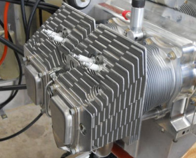

winsor68 Posted August 6, 2014 Posted August 6, 2014 Routine maintenance. Being certificated (NOT certified) does not remove the necessity for maintenance. The fact that it's necessary suggests that the valve guide temperatures are a bit on the high side - which again says that the CHT is getting a tad higher than was demonstrated during the 50 hour certification endurance run.The temperature limits given in the TCDS are based on the temperatures that were exceeded for at least 50% of the endurance run; that's how they were established in the first place. The engine has to be run for 25 2-hour blocks, during the first hour of which the power is varied from idle to takeoff power; and the second hour is held at maximum continuous power, and red-line temperatures. CASA sits-in on all such tests. The engine is stripped and inspected afterwards, and carbon build-up in the guides would have been seen - so one must therefore deduce that if they are carboning up in service, then the CHT and/or the EGT are exceeding the TCDS limits. Hence my comments re the cold junctions. I don't think you are correct re Lycomings etc; it doesn't have to be done frequently, but those air-cooled engines all run very close to limiting conditions for the exhaust valve guides. Continental has gone through about four changes in exhaust guide material over the years, and they still give trouble. The Rotax has liquid-cooled heads, whose main advantage is that they make it easier to cool the exhaust guides. Some Lycomings have oil passages in the head to try to reduce the guide temperatures; I hate to imaging what the maintenance issues are when those passages carbon up, as they must. Cars don't do it because they do not run the same duty cycle as an aero engine. I thought they were exempted from strictly following the CASA schedule...
alf jessup Posted August 6, 2014 Posted August 6, 2014 Port flow affecting cooling? You are so far off understanding the physics of heat transfer that it is bloody laughable.Sorry, edit - delete 'laughable', insert 'hilarious' Oh, and just by the way, in regard to your claim - the heads are not 'Cast', they are CNC machined. If you had actually ever seen Jab. heads in the flesh, you'd know that. You are so much male bovine excrement, you'd overlay a Texas Rodeo paddock. Oscar, You better be careful, I didn't see anywhere he mentioned Jabba Routed heads????

bexrbetter Posted August 6, 2014 Posted August 6, 2014 Oscar,You better be careful, Meh, the guys playing childish semantics to try to score some sort of points for reasons unknown to me. The heads belonged to VFR Pilot, a member of this forum. He wanted to do some stuff so I offered to have the heads ported by one of Australia's best so he sent them but my guy didn't think there was any great gains to be made due to not enough metal in the right places hence the inability to reshape them so back they went to VFR. I paid for everything.

alf jessup Posted August 6, 2014 Posted August 6, 2014 Meh, the guys playing childish semantics to try to score some sort of points for reasons unknown to me.The heads belonged to VFR Pilot, a member of this forum. He wanted to do some stuff so I offered to have the heads ported by one of Australia's best so he sent them but my guy didn't think there was any great gains to be made due to not enough metal in the right places hence the inability to reshape them so back they went to VFR. I paid for everything. It's ok Bex I was just stating that you never mentioned what heads they were so you could have been dishonest and said they weren't that cheap brand they were something else. No biggie to me I don't need to tinker with what I fly behind and I don't need to defend it to the hilt either as they stop on a not so regular basis and usually don't need much more than oil & plugs in their life time. Mines not bullet proof I know but I have more trust in it than the well talked about one. Alf 1 2
deadstick Posted August 6, 2014 Posted August 6, 2014 As anybody with a basic understanding of four-stroke engine thermodynamics knows, there is bugger-all heat transfer through port flow in the exhaust port. The valve stem carries some of it, the valve guide and the seat carry the rest. The head and the cylinder ultimately dissipate the heat to the cooling medium (water, oil or air). Titanium valves, sodium-filled valve stems, beryllium-alloy valve seats and various types of valve guide materials have all been used to improve the heat transfer / heat tolerance regime, with titanium valves being also useful for valve-train inertia reduction . No race engine engineer I have ever met/worked with has considered port flow from the POV of heat transfer from the valve/ seat/guide - though as you say, flame front/ velocity erosion is a matter of concern. Our wee mate Bex appears to be suffering from a spatial dislocation of his mouth to about two feet south of its conventional location. Not a good look in a supposed engine designer.[/QUOTE]"our wee mate" lol I bet he'd love to meet you in person! I know I do! 1

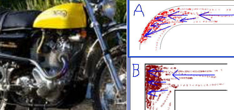

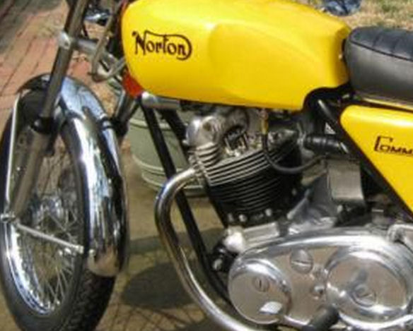

bexrbetter Posted August 6, 2014 Posted August 6, 2014 on porting. See where the hottest part of this exhaust system is, a bit of thought will have you understanding where and why while I'm off to dinner .. 1

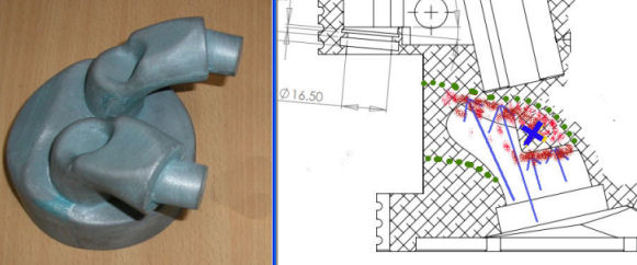

bexrbetter Posted August 6, 2014 Posted August 6, 2014 See where the hottest part of this exhaust system is, Anyone involved with older bikes knows where the exhausts "blue up", on the outer edge of the first bend. The reason is simple, anything with mass that is moving has inertia and doesn't want to change direction, be it a ball you throw, a car you want to turn a corner or in this case, a rapidly flowing gas. It's one of the fundamental rules of physics. Very simply the gas, bloody hot gas in this case, goes straight to the outer wall of the bend in the pipe, the sharper the bend the worse it is. Here is another example of a different Norton with even tighter pipe bends and hence even greater blue'ing of the pipes along with quick MS Paint of why including a 90 degree bend which is naturally worse.. Now I don't think that's so hard to understand, so now onto the relativity of that to the Jab exhaust port. Although I understand the reasoning behind the Jab exhaust port, packaging mostly, at the end of the day it's pretty awful. It's basically a quite sharp aprox 70 degree bend that as I have laid out in the above MSPaint picture, directs an enormous amount of heat to the port's roof, of course that's where the exhaust guide and valve stem are, but far worse is the amount of port space that is taken up by the exhaust guide boss, have a look at a casting made of the ports to see what I mean and my depiction (on an actual Jab port blueprint) of where the exhaust gas are doing the worst, the blue 'X' is the guide boss protruding into the port .. Just for comparative purposes, here is a port casting from a Falcon 6, notice the port bulge around the (much smaller) guide boss to help flow past that point and look again at the Jab port casting and ultimately, a Formula 1 port casting. f1 don't run much in the way of a guide boss port intrusion as they are relatively short life. Because they have ports that are as straight as possible for best flow, the valve ends up very long ... IMO, and you can see how I come to the conclusion, is part of Jab's problems might be attributed because they went a bit far with the packaging to offer a narrower engine, which is understandable. Some of you may now better understand why I wanted to port the heads to ease the restriction around the guide boss area so not so much heat was retained there as well as straighten out the port as much as possible to help it not condense on the roof as much - but not much can be done with out starting from a scratch redesign. 5
bexrbetter Posted August 6, 2014 Posted August 6, 2014 In my opinion there is another choice, respective to price and hassles etc. of going to watercooled. Porcupine heads stated to become known and popular in motocross racing around the mid 70's and took off with many aftermarket heads available before the onset of water cooling. Here is a standard 125 mid 70's air cooled MX bike head and an aftermarket porcupine to illustrate a bit .. And, here is a picture of the 1974 World Championship winning CZ Falta 250 along with the original 1973 engine, where the works team not only porcupin'ed the head, but also took every second fin from the barrel as well for better cooling and less weight... It may seem counter-tuitive to remove finning, but you actually increase extractable radiant area which is more important than finning area. Lots of fins are useless if you can't get the heat away and even worse, too much finning acts as a solid block. So you would end up with a VW head, because that's what I was discussing elsewhere, that would look roughly (and I mean roughly!) like below, you merely make cuts with a hacksaw and break out every second fin tab with a pair of pliers ... And of course, a Jab would look something like this ... After seeing today the test cooling cell posted above by Dafydd, I now understand why Jab did the finning as tight as they did.
