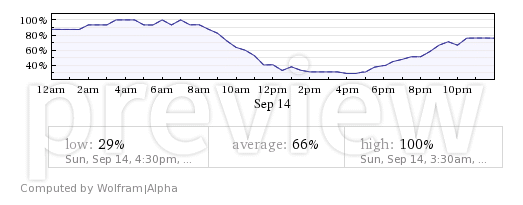

Local weather report may help. Humidity/ dew point for the day was? No evidence as to why engine failed to respond....... anyone see where i am going with this?
According to Wolfram Alpha, the humidity at the time at Mudgee may have been somewhere between 50-60%, and the temp around 20 C. I guess that makes carb ice on descent a possibility.
WolframAlpha--weather_in_mudgee_on_14_september_2014--2014-11-04_0253.gif.c43a47c7e375cdd8512fbcb47e59da10.gif

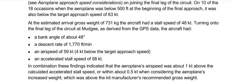

  Quote
The ACCIDENT was caused by aerodynamic problems related to weight and airspeed leading to loss of control.
the pilot put the aeroplane in a situation such that loss of control was likely.image.jpeg.796f8413b458bf0bcd72e4d7021d3cd1.jpeg

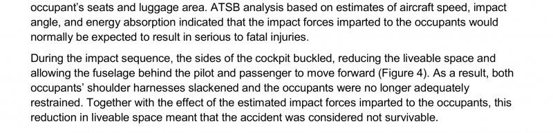

Yet another RV6 kills its occupants by structural failure of the cockpit. .... The FATAL INJURIES to the occupants resulted from deformation of the cockpit structure.
analysis shows that it would've been fatal regardless of that deformationimage.jpeg.cb9f737aa18deb341199be4180319b0c.jpeg

DJP - with respect, I believe the ATSB report stated that the cockpit buckling meant that 'the occupants were no longer adequately restrained.' The comment you have quoted is: 'together with the effect of the impact forces' etc. the accident was considered not survivable.
I read this as: 'due to the cockpit sides buckling, the occupants were not restrained from impacting the deformed structure.'
I guess we won't know until the coronial report, whether the cause of death was fatal crushing of organs etc. due to deceleration forces fed through the restraint harnesses, or blunt force trauma of impact of (usually) the cranium into a structural component. Let's both hold judgement on that.
On the aerodynamic contention: the ATSB report suggests that it was right on the thin edge of uncontrollability - but on the correct side of that edge. You know that the POH figures are derived with a margin for safety - but they are derived in 'normal' conditions. The RV6 has a well-known problem with elevator authority in an engine-out situation.
With a GPS derived airspeed of 4kts below the correct approach speed I would assume that the headwind would have lifte the airspeed to above the approach speed required. I know with a good headwind, my GPS speed on approach is frighteningly low. That is why we shouldn't use GPS for speed control unless we are sure of the actual wind speed.

I would have assumed that the atsb would take into account the current winds at the time of the incident and have allowed for that in their findings.
I think you got it in one SDQDI. From the report:
A review of the accident and 22 previous final approaches was performed using the recorded
GPS data and wind information from the aerodromes visited by the aircraft during those flights.
  Quote
When I did the Phase 1 flying on my RV6 in 2001, the Vso = 48 KIAS, which then gave me a calculated approach speed of 48 KIAS x 1.3 = 63 KIAS, ie, exactly the same as the Mudgee RV6. What I found in the flight testing of this RV6, and several others, was that the 'break' is sudden. ( I always used some power x 65 KIAS for general landings). It's even more so when you load up the wing in a turn of even 30 degrees. At 48 degrees it would have been very sharp.
So, if you allow your RV6 to enter a steep turn during a descent - add power to give you elevator command. In a gliding turn - use 65-70 KIAS and keep turns to 30 degrees. There is no need to be making a 1770 fpm descent rate, in a 48 degree turn in any circumstances - let alone turning onto final.
The RV6 is a great little performer - it just needs to be flown with due care and regard to the laws of aerodynamics.
