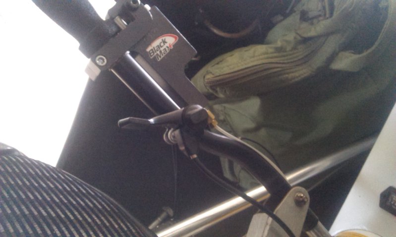

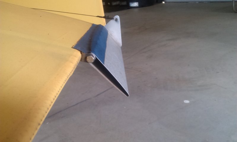

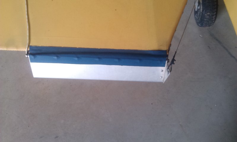

Drifters produced by Wayne Fisher (Fisher Mk1) had a cockpit controllable tab fitted to the port elevator.
If you go to the Spectrum Aviation web site (still up) and examine photos carefully, you will see the tab.
From memory a horn on the tab was operated by a small diameter bowden cable, such as might operate the gears on a push bike.
There was one horn pointing up from the tab's upper surface. Another pointed down from the lower surface.
To the second horn was attached a length of bungee cord that stretched forward to a mounting on the elevator. Bungee diameter was about 5mm.
Thus the cable pulled against the bungee so that the tab did not flutter.
The SB582 at Caboolture Recreational Aviation has the lever control. JimG ( not Jim G) this forum is CFI that machine. If you PM him he may be able to assist.

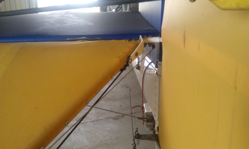

Hope these images help. You could try moving the battery aft or a weight down the tail

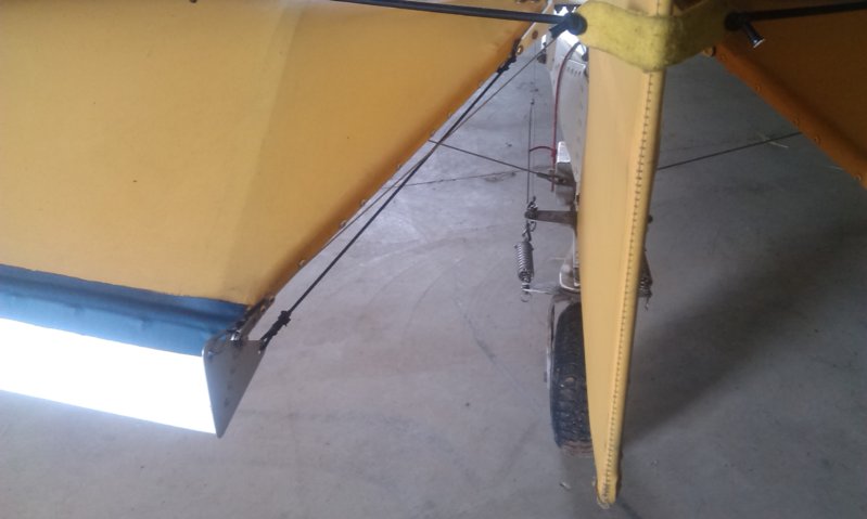

G'day Skyfox,
This is the install on my Drifter. This was done by Wayne Fisher before I picked it up. There is a cable running the length of the boom in a runner every 3-4 ft. ( I think they are all bike parts?) 999006191_Trimtab3.jpg.b8b6dace7298c77be76ed6d0d29982ac.jpg
You also need to check the AD's on the RAA website about Drifters as I think there was a defect report on them for the wire rubbing on the elevator.
Hope this helps.

Thankyou very much guys the pics are great help .
cheers Geoff
