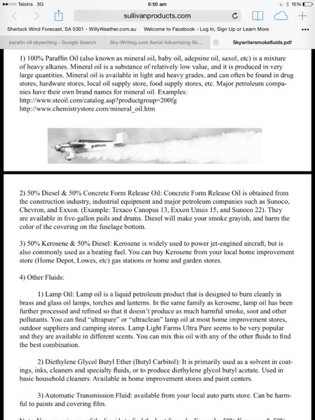

flyerme Posted November 18, 2014 Author Posted November 18, 2014 Found this.... I can get 20 ltr drum of paraffin oil from the fodder store$$? Might be worth a go , prepared to pay a lil extra than trany fluid for an environmentally friendly burn.
