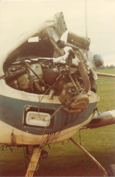

johnm Posted September 23, 2014 Posted September 23, 2014 photo's attached are a broken in flight prop ................ in the circuit Carbs were pulled out by vibration ! 1
