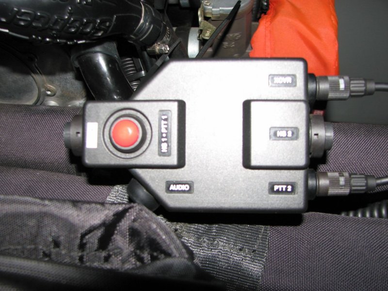

DingerPPC Posted September 30, 2014 Posted September 30, 2014 I have a Verex VXA 220 which is a great unit that I use in my PPC,but yest. it decieded not to work once I plugged in to my remote PTT button/headsets etc. it works fine as a handheld but PPC a bit loud for that.Im hoping someone out there can shed some light on what I can try as no one around here (Yamba) does work on them,thanks in advance.

DingerPPC Posted October 3, 2014 Author Posted October 3, 2014 Yep ,the radio plugs in to a Lynx junction box off which comes the 2 headsets & push to talk button & was all working fine then nothing but as I say works fine as handheld.I should google how to do some testing with my multimeter I guess as Ive only ever used it for basic stuff ie 12v & alternating power

DingerPPC Posted October 4, 2014 Author Posted October 4, 2014 Thanks for th replys,it may be something simle Im not overly smart with this sort of stuff .No battery ,only in the Verex . Radio is fine until I plug in the lead going to junction box for h/sets etc then nothing ,even if I push the talk button on the radio its self & squelch they don't work until I pull that lead out then fine ,so Im thinking it may be the connection in the top of the Radio or the lead going to Lynx junction box which I could probably test with multimeter if I knew a bit about it ,cheers

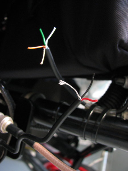

DingerPPC Posted October 31, 2014 Author Posted October 31, 2014 Can anyone tell me is it ok to cut off the plug going in to the Vertex radio & attatch the proper one ,Im not sure of the wiring inside these leads ,cheers.
M61A1 Posted November 1, 2014 Posted November 1, 2014 Can anyone tell me is it ok to cut off the plug going in to the Vertex radio & attatch the proper one ,Im not sure of the wiring inside these leads ,cheers. As long as you know which cable/ pin does what, it's not difficult.
DingerPPC Posted November 1, 2014 Author Posted November 1, 2014 Ah well ,made th snip but now 4 wont go in to 3.I may be looking for a new lead me thinks,anyone know of a good coms store to chase one up.Problem Im having is it being Lynx one end & Vertex the other
DingerPPC Posted December 5, 2014 Author Posted December 5, 2014 All sorted ,new lead fixed th problem 1
