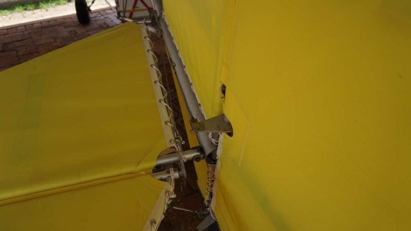

keefy Posted March 27, 2015 Posted March 27, 2015 Hi Wayne Glad to hear you are progressing well with your kestrel, I'm sure you will be very pleased with the end result, they are a very tough and under rated aircraft. I am surprised to hear that your tailplane is not of the folding type, without this facility it may not fit in a road legal trailer should you feel the need to take it home or away on a road trip. I still have mine for sale as the photos did not do it justice so decided to refurbish the trailer and put it on ebay in mid May after my holidays. As I mentioned before I have some spares that may be useful if a new owner does not want them.

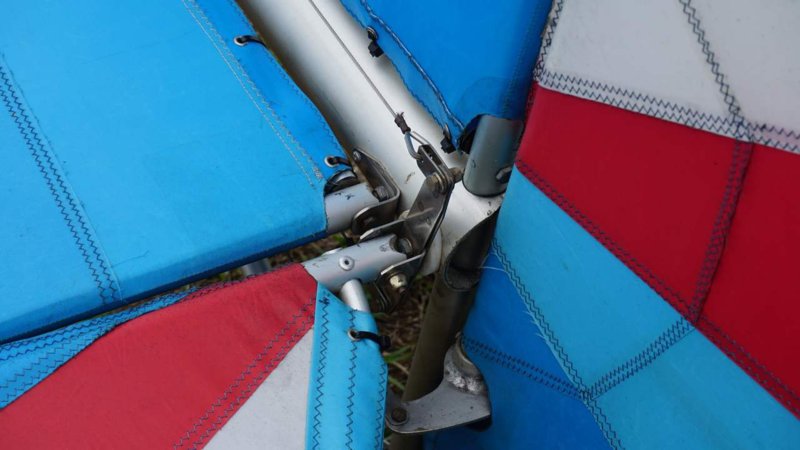

WayneL Posted March 27, 2015 Author Posted March 27, 2015 G'Day Keith, My Kestrel tailplane will pivot up but only about 60 degrees, still enough to put in a trailer but I like what I saw on Howards plane better. I'm guessing yours is the same design too. The photos show the difference. Are you putting the Kestrel and Trailer on Ebay or just the trailer? You will have to pm me a list of spares. Wayne
