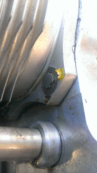

Guest Bruce Knowles Posted November 18, 2014 Posted November 18, 2014 SPLIT BARREL AND BROKEN (NEW) THROUGH BOLT SUPPLIED BY JABIRU THE RESULT OF WHICH WAS ENGINE FAILURE RESULTING IN FORCE LANDING:oops:

brilin_air Posted November 18, 2014 Posted November 18, 2014 Bruce. You forgot to add that the 3 standard jabirus that made that trip with you, all did it without incident. Also it wasn't a standard barrel that was honed.... 1 3
