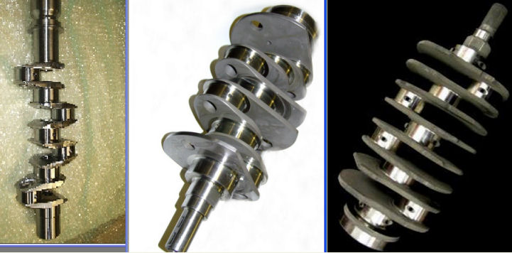

bexrbetter Posted November 22, 2014 Posted November 22, 2014 But I had a vibration test done and the level was not high. People compare the Lyc, Conti, Rotax etc but the fact is they are all short, stiff, 3 main bearing cranks, Jab has a longer 5 main bearing crank without counterweights, a Subaru with 5 mains has counterweights, there's 100% no doubt it twists/flexes but if that's a cause of the problem, i.e. the resulting TVs, I don't know. If I was at CAMit I would be trying a fully counterweighted crank or at least a semi counterweighted one for results. For the purpose of testing, it's as easy as welding on the counterweights. Here's a Jab, semi-counterweighted Subaru and fully counterweighted Subaru cranks for comparison .. As for TVs, just because you can't feel them doesn't mean they aren't there. The following isn't my writing, nor my area, but I do know someone far better equipped and I will contact him, it's quite a science to itself apparently ... Please take note of the last paragraph (tongue in cheek). Torsional Vibrations: Torsional vibrations are much harder to identify because they are often not felt. Torsional vibrations exist in all rotating equipment (electric motor, reciprocating engine) throughout the entire operating range. However, at certain speed/load (can be multiple locations) conditions they are magnified. When a component’s natural resonance becomes excited by the frequency source, the component is subject to extremely high movements. It is these extreme movements that generate forces equal to multiple times the expected force. An example is the tuning fork breaking the glass. The damage from a torsional vibration is typically unexpected and unexplainable by the serviceman. Torsional analyses can predict the speeds at which a system may become resonant, thus allowing design engineers to retune the system. This tuning is accomplished with various methods to include torsional couplings. The calculations and instrumentation is typically performed by the equipment manufacture, system packager, or torsional coupling manufacture. The individual components’ mass elastic data is required as well as the operating speeds and any special conditions; shock loads, load reversals, desired life, etc. On fuel powered reciprocating engines such things as fuel pressure, firing angles, cylinder mis-firing, light rotating inertia, front viscous damper, light inertia driven loads, and propeller excitation also contribute to the torque excitation. Once a base line vibration analysis is established, it becomes an invaluable tool for identifying component wear and preventing costly failures & downtime. A relatively unknown result of torsional vibrations is full torque reversal in which the applied torque actually passes back and forth through zero. If a gear set is subject to this, a severe rattle can occur as the gear teeth load and unload. The noise generated by this action can be very loud. Keep in mind that the gearing itself may not be causing the noise as it is not defective but operating at a natural resonance. This is why a seemingly proper sized shaft/gear/spline/bearing will wear very quickly. This applies to gear reducers, hydraulic pumps & motors, hydraulic & mechanical transmissions, etc. The coulomb damping is the relative movement between connecting surfaces. This is what the torsional coupling is designed to control and maintain throughout the entire operating range and for the entire operating life. Coupling selection for a power transmission system involves analysis of its dynamic torque capacity, either by a TVA calculation or direct field instrumentation. Dynamic torque and torsional critical speeds must be taken into account. Because torsional stiffness can be more easily adjusted at the coupling, the coupling is often the component that ensures torsional compatibility for the entire system. Such systems then operate at speeds that do not induce resonance, or they have enough isolation capacity at the critical speeds to control vibratory response. Systems that are dynamically compatible need low service factors, tend to be trouble-free free, and have long service life. If you suspect torsional or linear vibrations exist in your equipment contact your equipment OEM, packager, component OEM or coupling manufacture to discuss the problem and possible diagnoses. 1 6
facthunter Posted November 22, 2014 Posted November 22, 2014 Bex...You are on the ball .Way over the head of most people unfortunately, as they don't have the training in basic physics nor do they perceive the relevance of the points you make. You don't "feel" torsional vibrations nor have any appreciation of the magnitude of them, until something breaks. Nev.
