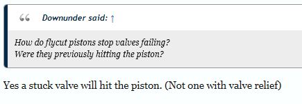

vk3awa Posted November 30, 2014 Posted November 30, 2014 All of the issues you have mentioned are correct over the history of the 2200/3300 series of engines. However, some of the problems you have raised may no longer an issue as they have been rectified over time or the affected engines are no longer in service. You quote "larger" valve relief.........not larger but either valve relief machined into the piston crown or not. I have been involved with the Jabiru product since before the intoduction of the 2200/3300 series engine having my first flights in a 1600 powered version. I am an L2 and have ben trained by the Jabiru factory and Wayne Johns in SA on Jabiru engine rebuilds so I have some experience. The current prevalent issues are through bolt failure/crankcase fretting and valves sticking in guides. The piston valve relief might be a "bandaid" fix but I can tell you that I'm a lot happier flying with one of these engines knowing a stuck valve will not cause a catostrophic engine failure. I also read a few posts citing engine overheating problems. This has not been an issue since the introduction of the fine fin series of heads some years back. So, during the evolution of the engine the issues have changed. My feeling is CASA will be targeting the current series of production engines and not ones made ten years ago with some of the problems you have raised in your post. Just reread my post.....apologies for the typos......but you get the message.
Downunder Posted November 30, 2014 Posted November 30, 2014 The solution to sticking valves is to flycut the pistons? THATS NUTS! Treating the symptoms, not the cause....... 4 1
