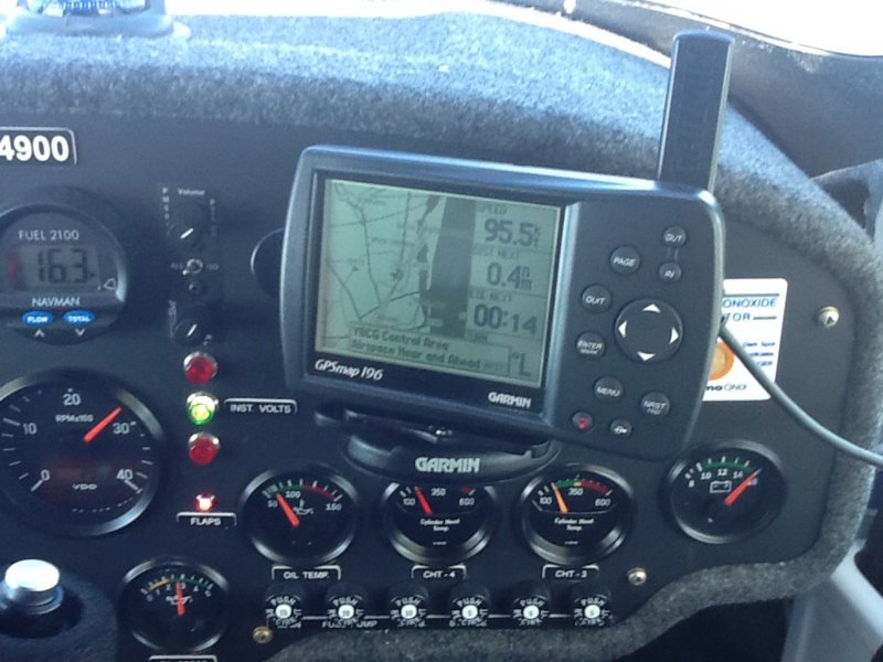

biggles Posted December 8, 2014 Posted December 8, 2014 A picture is worth a thousand words . This shows my CHT's running at 200 degrees F . Bob
Russ Posted December 8, 2014 Posted December 8, 2014 Sure does... 16.3 LPH ...28ish revs........me same revs 15 ish. Latest jet kit too. ( did you jet even bigger ) ??
facthunter Posted December 8, 2014 Posted December 8, 2014 Running at 200 f is a bit cold. You try to get above that with liquid cooling, where fitted . Probably about 225 would be ideal. The head temp cannot be uniform as there will always be higher temps near the exhaust port. That is the nature of the design. Extra airflow means more drag, so utilising whatever airflow you already have more efficiently is a good idea. Some kind of inflight adjustable cowl flap will get you the best situation. but a little more trouble to organise and potential for finger trouble . Having a set warning signal would overcome that. Nev
biggles Posted December 8, 2014 Posted December 8, 2014 Don't get too excited fellas , this was taken on descent into Southport , and there is some lag in the fuel flow indication . The CHT' s normally run around 220F , with OAT around 22F , and flying S&L . Fuel flow at or near MTOW is 16.9 - 17 l/hr at 2950 RPM . Jetting and fuel flow are as recommended by Jabiru . A bit of parallax error there I think Deb but I'll have to speak to the photographer , anyway battery nearly 7 yrs old now since manufacture . Engine now has 340 hours and untouched apart from mandatory upgrades . Bob

dlegg Posted December 8, 2014 Posted December 8, 2014 That fuel flow looks a tad low for a 3300 @ 2800 RPM. Bob I read conflicting reports on recommended head temps for cruise....Jabiru don't publish a range to aim for, rather just a max to avoid. Limbach recommend cruising at between 150-170c , but to keep below 200c at all times, as per http://byrongliding.com/wp-content/themes/common/docs/Limbach_Tech_Bulletin_44.1.pdf That fuel flow is with standard jab bing and drops down to 17lph at 2750 rpm, goes up markedly above 2850. I presume the tapered needle is doing its job....

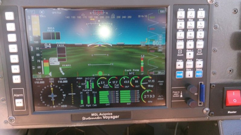

Captain Posted December 8, 2014 Posted December 8, 2014 While we are into show and tell, here is mine on a 230 at 2880 rpm, just levelling off at 6,900 ft with 11 C OAT. CHT & EGT were usually highest for me on 2 and 4 with plenty of air getting to the back to cool 5 & 6 (and this needed to be watched on descent to stop them getting too cold, so usually needed power on a little while descending). I also always suspected that the J intake plenum was a bit of an issue and did not evenly distribute to the cylinders, but that can never be perfect. Note carb temp was 3 C at top of climb and oil was 74C. 1

jetjr Posted December 8, 2014 Posted December 8, 2014 Captain those are awfully similar to my numbers, good to see, thx

Teckair Posted December 9, 2014 Posted December 9, 2014 just levelling off at 6,900 ft[ATTACH=full]33117[/ATTACH] Mmm is that where you should be?
rankamateur Posted December 9, 2014 Posted December 9, 2014 Mmm is that where you should be? Not above 5000', 4900" would have been better. Maybe he was IFR?
biggles Posted December 9, 2014 Posted December 9, 2014 Mmm is that where you should be? Mmm , do you think that he should have been levelling off at 7500 Teck ? Bob 2
Captain Posted December 9, 2014 Posted December 9, 2014 Sheeeeeeeeeeeesh you blokes, Traversing a little bit of rough country sitting behind a 3300. How high do YOU think is safe? And with a number of saleplanes above & below at the time. Plus an ingrowing toenail. 4 2
Teckair Posted December 9, 2014 Posted December 9, 2014 Mmm , do you think that he should have been levelling off at 7500 Teck ?Bob Yes, 7500 or 6500 depending on which direction he was going. Richard. 1
