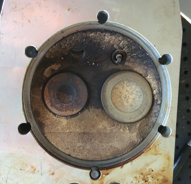

01rmb Posted December 12, 2014 Posted December 12, 2014 Merv - The experience was exactly the same - fouled cylinder heads, valves (especially exhaust) and plugs. Valve and plug fouling and many little rough running niggling issues has completely gone now that mogas is used. The photo below was at 300 hours. You can see the lead build up and the burning on the exhaust valve near the plug (the one that has been removed). The cylinders had similar thick light brown build up. After a good clean and running on mogas the heads and cylinders are still clean 100 hours later when one of the heads came off again to replace a compression ring in one cylinder stuck and needed replacing. (The cylinders were not touched when the heads were cleaned so it was possibly still a legacy from the avgas. Probably should have done the lot at the time.) I have had a few long chats with a long time family friend who was head of Shell aviation - he also identified that the lead from the avgas from the blowby gas will contaminant the lubrication oil and will combine with water to become an acidic paste. With such a low oil volume in the jabs, it doesn't take much to completely contaminate the oil to become a sludge and cause loss of lubrication, rusting and increased component wear. I believe that Jabiru after consulting a few people and in discussions with Shell changed the oil change schedule to 25 hours from the original 50 hours. Below are a couple of references that are worth a read. Note they specifically mention Rotax being designed for unleaded fuels and the potential that a hotter plug could be used to reduce lead fouling if avgas is used. http://www.shell.com/global/products-services/solutions-for-businesses/aviation/aeroshell/knowledge-centre/technical-talk/techart18-30071600.html http://transairpilotshop.wordpress.com/2011/11/03/winter-and-the-oil-in-your-aircrafts-engine/ I have spoken with Jabiru about avgas and whilst they acknowledge these issues they are uncomfortable with the variability of mogas and the increased potential for other issues such as detonation. I also feel that they don't want to alienate those that have avgas on hand at the airfield. It is far easier for me to fill up with Avgas than have to lug jerry cans of mogas but the experience has been way better on mogas and I would not go back to avgas given the issues that myself and the flight school has experienced. As long as the mogas is 95 or greater (we use 98), has no ethanol, is kept fresh, and not push the cylinder temps too high there should not be too many problems. But don't let it dry out - Where somebody has spilt some on a wing and left it to dry there is an awful syrupy residual mess that was hard to clean off so I would hate to see what it would look like inside a carburettor if it were left to dry out. Bring on unleaded avgas!! 2
motzartmerv Posted December 12, 2014 Posted December 12, 2014 Carbon copy of how ours used to look. Infact some looked worse in places. I can't find the pics I have of th pots after running Mogas. So much cleaner looking and more uniform coloration
