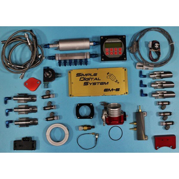

Downunder Posted November 21, 2014 Share Posted November 21, 2014 Do the electronic injection systems have individually adjustable injectors (fuel amount)? It should be possible...... Link to comment Share on other sites More sharing options...
facthunter Posted November 21, 2014 Share Posted November 21, 2014 The system is extremely simple using diaphragms to regulate the position of a needle that controls fuel flow flow. Starting the engine is a bit of tweeking with the primer, but there is no reason to not use the fall back simple throttle block idle system, and progress to the other above fast idle. Nev Link to comment Share on other sites More sharing options...
turboplanner Posted November 21, 2014 Share Posted November 21, 2014 A simple EFI might make a big difference. Is anyone working on this? You have to get the sonic waves right first. No point injecting a precise amount of mixture if it's going to be set on fire just as it's forced out the exhaust. Link to comment Share on other sites More sharing options...
jetjr Posted November 21, 2014 Share Posted November 21, 2014 Do the electronic injection systems have individually adjustable injectors (fuel amount)? It should be possible...... Not the ones available, im told it isnt necessary as distribution is even and engine should use it evenly. The piezo injectors actually operate all the time not per stroke, tiny pulses of fuel constantly i think With current carbs it appears we need to have differential injection Theres some EFIS pictures on Avcom illustrating Egt spread after SDS injection fitted, pretty nice. 1 Link to comment Share on other sites More sharing options...
