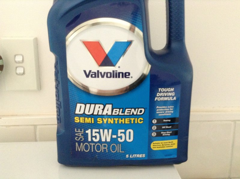

Guest Maj Millard Posted January 5, 2015 Posted January 5, 2015 The compression check on the 912 is virtually useless even though it is suggested as part of a normal 100 hrly by the manufacturer. You will always get good readings on a 912 until they get around the 2000 hr mark, and only then they may drop a little because a carbon buildup can be expected under the exhaust valve seats. The rings (square cut just like a VW) pistons ( forged alum Cima Mahle Porsche quality) and bore, ( all alloy - nikisil ) pretty much guarantee no loss of compression until very high times are reached. Even then simply removing the heads ( no gaskets) for a standard valve grind will always restore compressions to standard value. My 912 ULS has 900+ hours now and has never had a compression test done on it , nor do I intend to even think about doing one until it reaches TBO of 1500 hours. I'll bet you even then it'll still be ok, and well within range. Like any engine the best medicine is to use them often and don't baby them. I change my oil every 50 hrs ( Valvolene Durablend 15w50) and my oil filter every second oil change at every 100 hourly. I always do a filter cut and only use Rotax oil filters. The engine was run on Castrol GPS for its first 400 hrs until Rotax no longer recommended its use.
David Isaac Posted January 5, 2015 Posted January 5, 2015 I wouldn't run Valvoline in any of my machines Maj. There are far better quality oils on the market IMHO and not just MHO.
Guest Maj Millard Posted January 5, 2015 Posted January 5, 2015 Valvolene is one oil recommended by Rotax David.......It is doing just fine for me, over 500 hours now....wouldn't run a Shell product in my weed wacker personally.....
