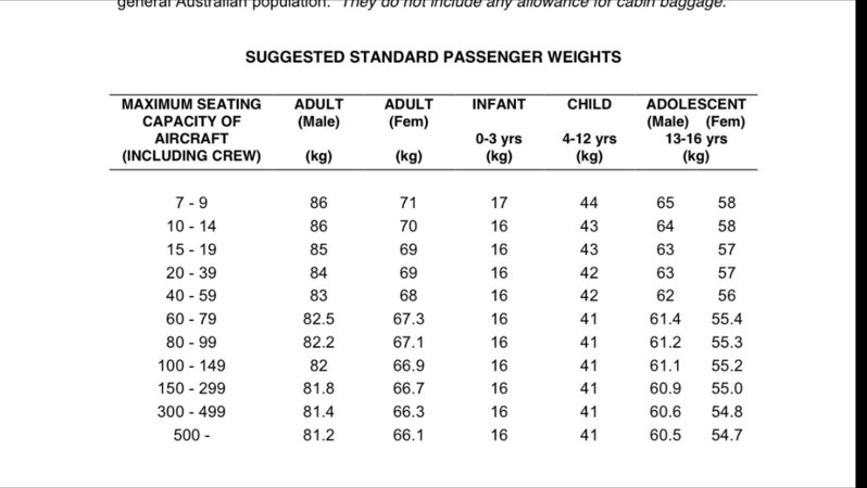

ben87r Posted January 10, 2015 Posted January 10, 2015 Not sure what RA use but standard pax weight would be 86kg
poteroo Posted January 10, 2015 Posted January 10, 2015 Not sure what RA use but standard pax weight would be 86kg And it continues to grow!!
ben87r Posted January 10, 2015 Posted January 10, 2015 From caap 235. What I left out for simplicity is the caap recommends under 7 seats it not be used in practice for W+B
poteroo Posted January 10, 2015 Posted January 10, 2015 Care to elaborate there pots? 'Standard weight' was 75 kgs for a male and 60 for female back in the 70's - if I remember correctly? Sometimes I don't! In any case, the Regs require that we use 'actual' weights and not rely on so called 'standards' anymore. The tongue-in-cheek in my 1st post was to intimate that, as a society, we are becoming heavier. happy days,
ben87r Posted January 10, 2015 Posted January 10, 2015 Ah sorry mate! Not how I read it but can see it now. I still use standard weights but only when I know I'm well under and in balance. Saves me asking, or having to weigh pax, and can do the paperwork before they arrive.
frank marriott Posted January 10, 2015 Posted January 10, 2015 'Standard weight' was 75 kgs for a male and 60 for female back in the 70's - if I remember correctly? Sometimes I don't! In any case, the Regs require that we use 'actual' weights and not rely on so called 'standards' anymore. The tongue-in-cheek in my 1st post was to intimate that, as a society, we are becoming heavier. happy days, Poteroo, not that it makes any difference to your post, only a memory test really, but I seem to have 77kg (male) burnt into my memory? Maybe it went up a couple of kgs in the late 70s, or "my" memory is slipping - 1
ave8rr Posted January 10, 2015 Posted January 10, 2015 I was referring to the "2 seats x 80kg + fuel for 1/2 the HP" formula that I've heard so many times...The 1320Lb MTOW limitation is set in stone, no argument there. I think you will find fuel is required for min 1 hour PLUS the required fixed reserve.
poteroo Posted January 10, 2015 Posted January 10, 2015 Poteroo, not that it makes any difference to your post, only a memory test really, but I seem to have 77kg (male) burnt into my memory? Maybe it went up a couple of kgs in the late 70s, or "my" memory is slipping - You could be right there. 77kg is pretty close to 12 stone, (168 lbs), which was always a sort of benchmark. If it's now 86 kg - then it just shows we are all growing. If we want to 'fit' into the 600 kg LSA - then it's going to need some crew weight reduction. I've reduced my weight from 83 to 73 kgs over 18 months by just using the 5:2 'fasting' eating program. Cheap, and a little bit 'painful' - none the less - very effective. cheers, 1
