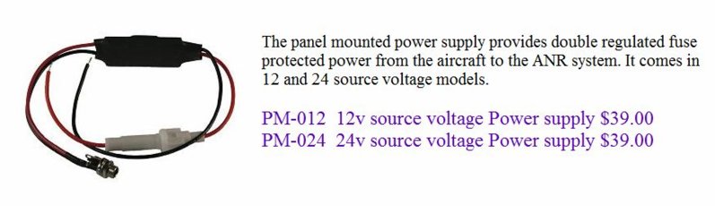

jetjr Posted December 26, 2014 Posted December 26, 2014 Must be ANR Yes headsets Inc make a direct hardwire kit Obviously the plugs etc match their ANR kits and headsets
Downunder Posted December 27, 2014 Posted December 27, 2014 As per jetjr above.. http://www.headsetsinc.com/Accessories.html You'll have to adapt it to your headset...Most headsets seem to be 9V?
