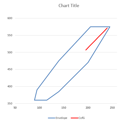

RossK Posted March 17, 2022 Posted March 17, 2022 (edited) Good post above by TP. It's not hard to know your MTOW and WB for each flight. I've got a spread sheet on my phone with a WB envelope. Enter Crew wt, baggage wt and fuel qty and it plots my WB for the endurance of the tanks. example below is from our trip to Mt Gambier, 165kg Crew wt, 17kg baggage, 95lt of fuel. (baggage includes tie down kit, travel cover, headsets, collapsible fuel bags and our travel bag.) Get a $10 spring balance and everything can be weighed before it goes in the plane. It's not hard. When we were looking at aircraft to buy, one of the first things we asked for was the planes W&B cert. I will add, that at YLIL, W&B was taught and tested during RPC training. Edited March 17, 2022 by RossK spelling 1 1
facthunter Posted March 17, 2022 Posted March 17, 2022 Useable fuel cannot be used to keep the plane in balance. At zero fuel Wt it must still be in balance. Nev 1
RossK Posted March 17, 2022 Posted March 17, 2022 On 17/03/2022 at 1:52 AM, facthunter said: Useable fuel cannot be used to keep the plane in balance. At zero fuel Wt it must still be in balance. Nev Expand Which is why I plot starting fuel (top right of the red line) all the way to zero fuel (bottom left), at all fuel quanties the CofG is within the envelope. We saw one W&B cert for a plane that had to have a minimum of 50lt in the tanks to keep within the envelope with 2POB, 90Lt tanks, so usable fuel of 40L!! 2
